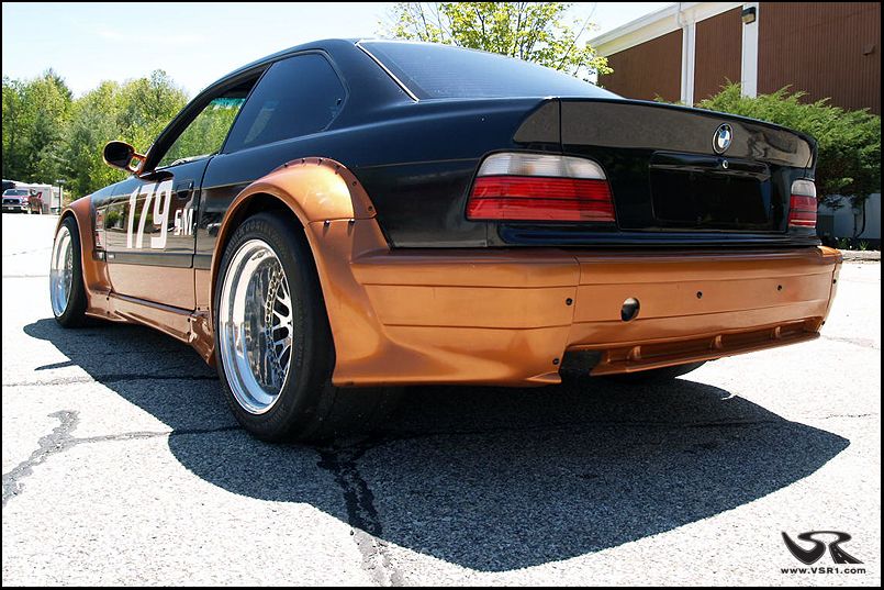

My car, which won SM in 2002-2003 and took 3rd & 4th in 2004: 434 HP @ 10 psi with 345s in the rear. Oh, and it can be yours for stupidly short money. :cry:
http://i253.photobucket.com/albums/h...b.jpg~original
