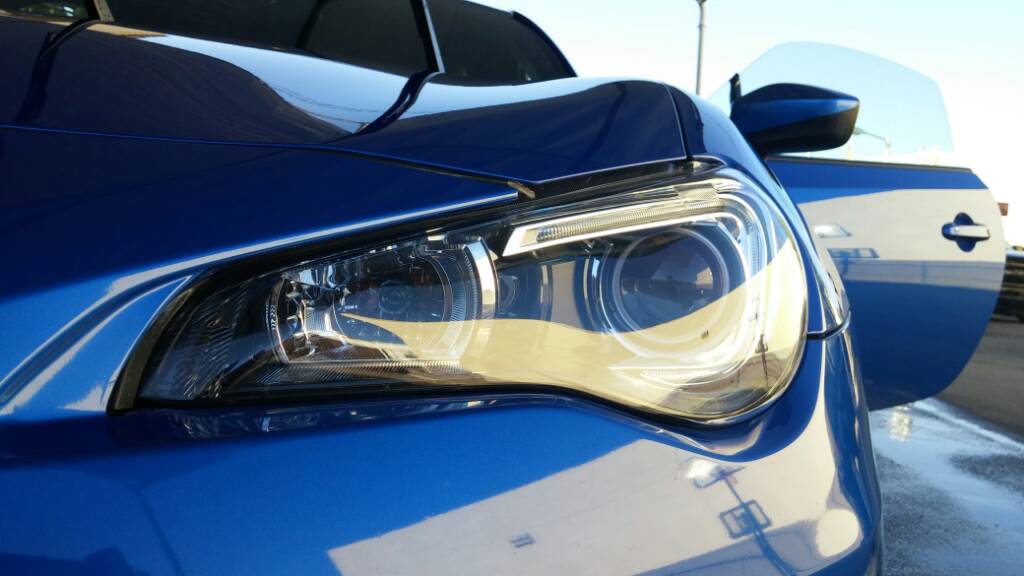

k.houan 09-05-2014 08:20 PM
Attachment 90008
Best one i have of the lights right now. I'll get one close up in about an hour.
Sent from my LG-D851 using Tapatalk

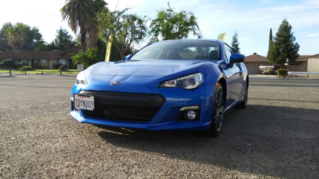

k.houan 09-05-2014 08:55 PM
Attachment 90009
Thoughts? Pics of yours if your interested.
