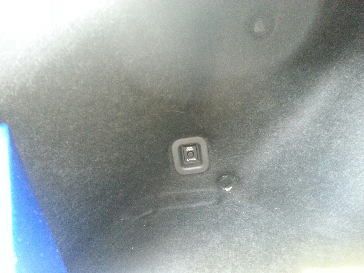

Hi everyone,
so just yesterday the trunk release stopped working on my 2013 FR-S. Neither the button inside the car, nor the button on my remote opens the trunk; I have to physically use the key to open my trunk...any thoughts what this could be? I called my dealer to setup a service appointment to get it looked at
Takumi788 09-04-2014 10:09 AM
There is a switch on the inside of the trunk that disables remote entrance. I cant remember what side its on but it is easily visible
FRSNewb 09-04-2014 10:10 AM
Might have accidentally put the car in some valet 'lockout' mode...going to check this at lunch and repost here...
BoxRZ_86 09-04-2014 10:11 AM
yeah I have done this too. a golf bag I had in the trunk must have pushed that valet button once and the only way for me to open the trunk was with the key.
sklimo 09-04-2014 10:17 AM
2 Attachment(s)
Drivers side in truck
Attachment 89833
Attachment 89834

aznatama 09-04-2014 02:13 PM
That valet switch needs a cover...
Tcoat 09-04-2014 02:23 PM
I just taped a piece of heavy plastic over mine after it got shut off by accident. May just disable it some day as I have very few plans of ever using a valet where I would need it.
