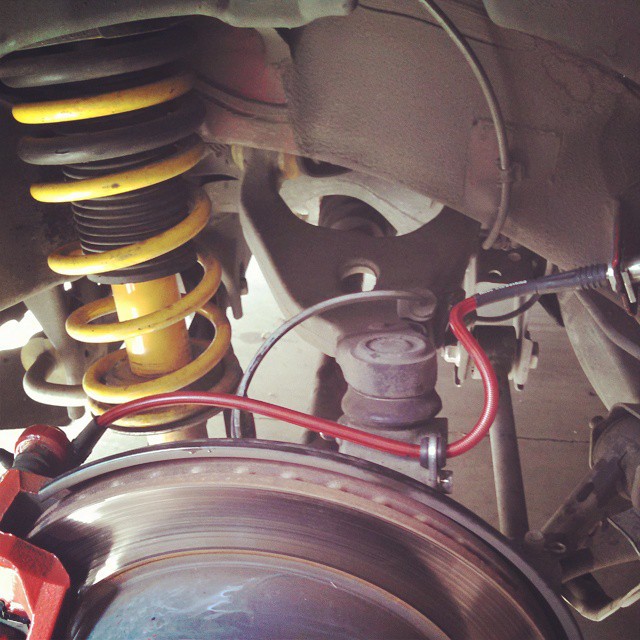

Installed the Mtec stainless steel brake lines with red rubber protective wrap
Installed the Mtec stainless steel brake lines with red rubber protective wrap. Install was straightforward thanks to this DIY from a fellow member. http://www.ft86club.com/forums/showthread.php?t=20311
The brake pedal feels a little less squishy now and more direct. Gives a little more confidence when braking. I'm on the OEM pads (I have separate track pads). The brake lines look cool as well. :) Picture below is of the rear brake line I installed.
Attachment 89490

jdubious 08-31-2014 08:01 PM
So the thin red rubber coating is supposed to somehow protect the stainless steel?!? LOL like hiring midget body guards to protect a pro boxer.
anyways...just saying...I'm sure they are as good as any other stainless line.

Poodles 08-31-2014 09:45 PM
And all other stainless lines are covered in a clear coating. Because it's a braided line, dirt can work into the braid and wear away the actual inner hose.

dem00n 08-31-2014 09:55 PM
I'd assume so given the ends and covering.
I couldn't find much. I started to question it when the first thing that popped up was eBay...
http://www.ebay.com/itm/MTEC-Industr...-/171302889660
Poodles 08-31-2014 11:50 PM
Interesting... Looked on Mtec's site and they don't offer brake lines, but the ebay store has their name and logo...

wparsons 09-01-2014 11:17 AM
All the stainless lines have a coating, most are just clear.
