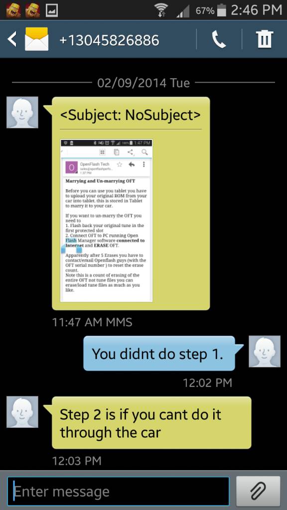

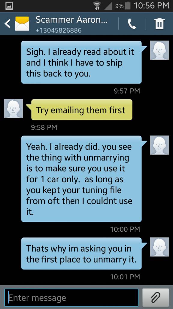

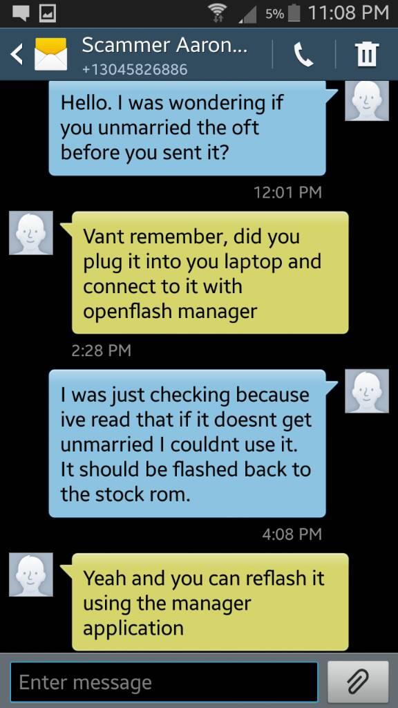

Yeah I want my money back because I couldnt use the thing. And you are telling people that I said it was fine to send it unmarried? Here you go. Attachment 89731Attachment 89732Attachment 89733
and btw. I will mail back the oft once I get the refund because I couldnt even use it. and I want to give it back to you because it will be more costly if we ship it back and forth.

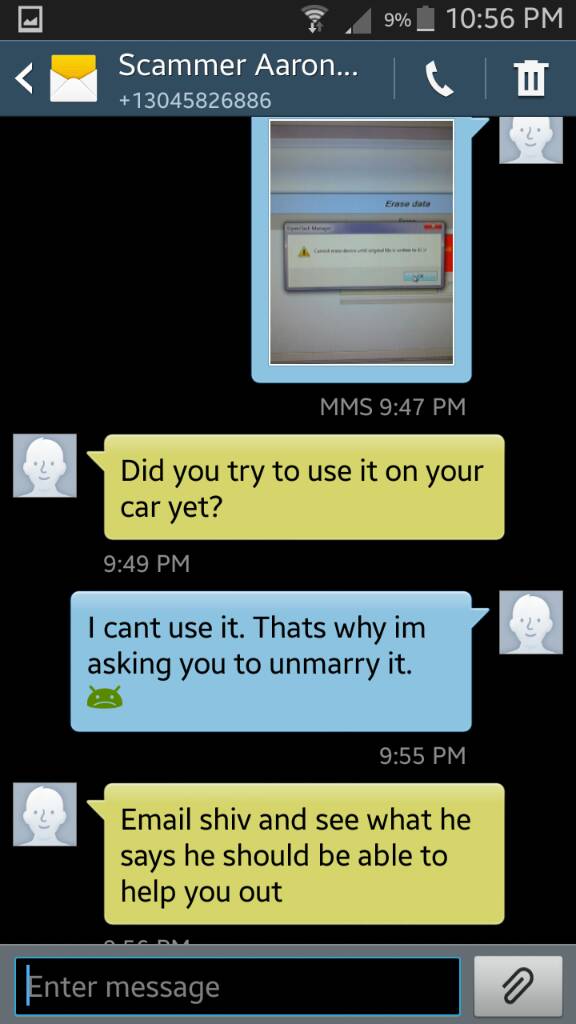

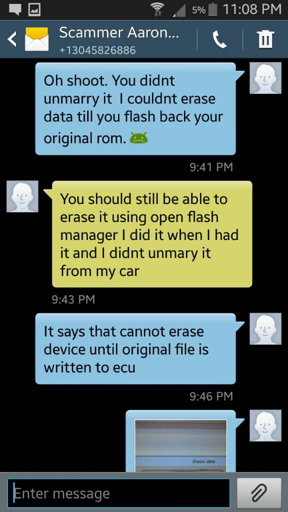

Here are mpre evidence that I asked him to unmarry it. He made me believe that I can use it if he didnt unmarry it. Attachment 89734Attachment 89735Attachment 89736
