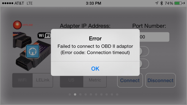

Attachment 90847
Every time I try to connect I get this message. I've tried changing the IP address and it still doesn't work lol

Your adapter should work. Did you select OBDWIFI or CLKDevices from your WIFI settings?
I selected OBDWIFI. I don't get a CLKDevices when I have the obd adapter plugged in

OBDWIFI is fine. Make sure that the IP address within OBDWIFI setting and the ip on connect page of EngineLink are not the same.

Worked. Thanks a lot.
