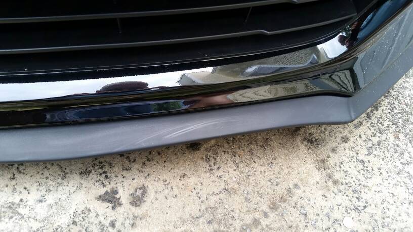

Attachment 86174
So like I said it's not "scratched" . Is there any kind of plastic cleaner or restorer?
Danklvr 07-27-2014 05:58 PM
try gentle heat to the area... that should get rid of the scuff

Interesting approach. Just curious why this would help.
Poodles 07-27-2014 09:36 PM
Heat tends not to work on urethane as it's not a thermoplastic like ABS.
Have you tried something like 303 Aerospace on it?

Yea actually just tried the heat gun and no luck. I have not used 303 aerospace nor do I know what it is.

Guzic 07-28-2014 01:54 AM
Hmm, looks like minor scuffing. You could try a back to black product but it might not help you in the long term. Here are some options that have worked for me in the past since I'm not sure you'll be willing to sand it. You can use a paint polish with a scrub pad such as those by Stay Fresh. You can also try to find a special plastic polish, though I honestly couldn't recommend any due to lack of use. Metal polish has also worked for me in the past on plastic as it does not remove the luster from PU. A weird one that has worked is, Toothpaste. It can't be the one in gel form however. Apply it with any fine woven cloth and it should take care of it. Let me know if you need any more ideas :)

Yea it's definitely a scuff and not a stain. Anymore ideas?

Plastic polish

The easiest way would really be to take a 1000-2000 grit sand paper and VERY, lightly, with virtually no force rub it against the scuff. If it still doesn't come off, try a 400 grit.
Have you tried using a polish as I suggested before?

Rubbing compound sounds like it would work for this
