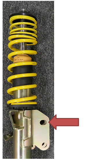

Attachment 85559 Should be the top bolt that connects to the spindle
Hope this helps
Originally Posted by bkstarx1 (Post 1855210)
Before I attempt to loosen the bolts, it's the 12mm bolts and not the 19mm bolts correct? Just loosen it up, push the coilover in and tighten?

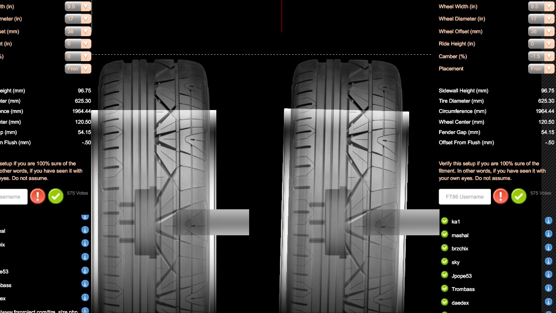

jshadeck 07-19-2014 08:13 PM
9.5 +38 is the reason for the poke, camber will make the tops poke less, but the center of the wheel will always maintain its current poke (and the camber will make the bottom half of the wheel poke more actually)
