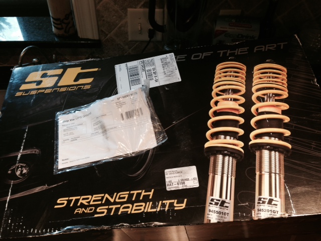

Before I talk about how great these coilovers are, I want to thank Terry @Maximal performance. Customer service was the best I'd ever gotten in regards to car parts. Shipping was fast and free, packaging was about 8/10 but nothing was damaged or thrown around so it's all good. I have pictures but they are not that great, I also forgot to do a before pic but we own this car so we know how it looks stock. Also going to be my first time uploading pics so i hope it works out okay. This is my first review and I'm going to keep it simple cause i should be studying for my math test right now.
Attachment 85255
Attachment 85256

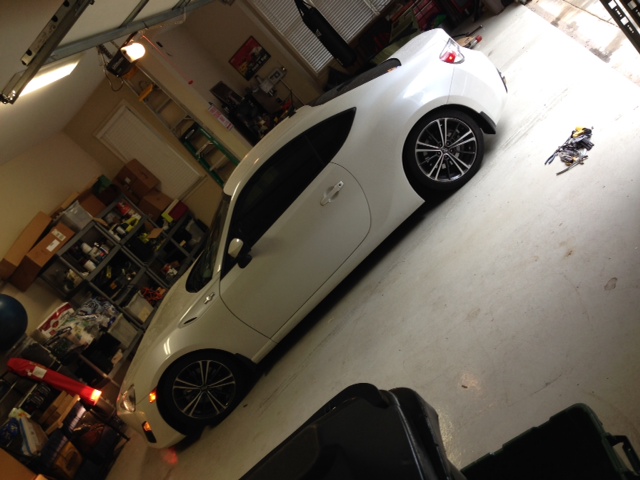

Now to the coilovers: I chose ST because the build is top notch, everyone knows they pretty much are KW V1s. The price for them is awesome especially if you're a college student like me. Bang for the buck is what I was going for and thats what I got. Installation was about 2 hours with me and my buddies help and we are nowhere near experts. The ride is pretty much like stock except a little stiffer, going over bumps you feel it a little more than stock of course but its not going to break your back. Even my parents were both surprised how well it rode. I'm running the stock 17's but soon i will be getting 18's, the front is lowered with 1 thread left and the rears, man do they go low there's about 6or7 threads left. Performance wise I can't speak up about that yet cause i need new tires badly and it was raining yesterday so I didn't get to try them out for that. They are a DD coilover though so it's most likely not going to be anything crazy compared to stock. Any questions or input on improving further reviews are accepted.
