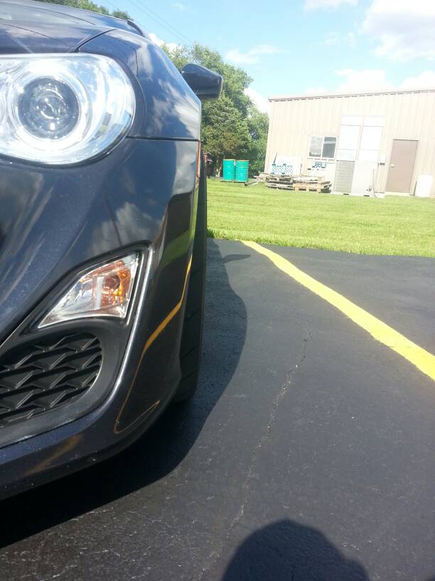

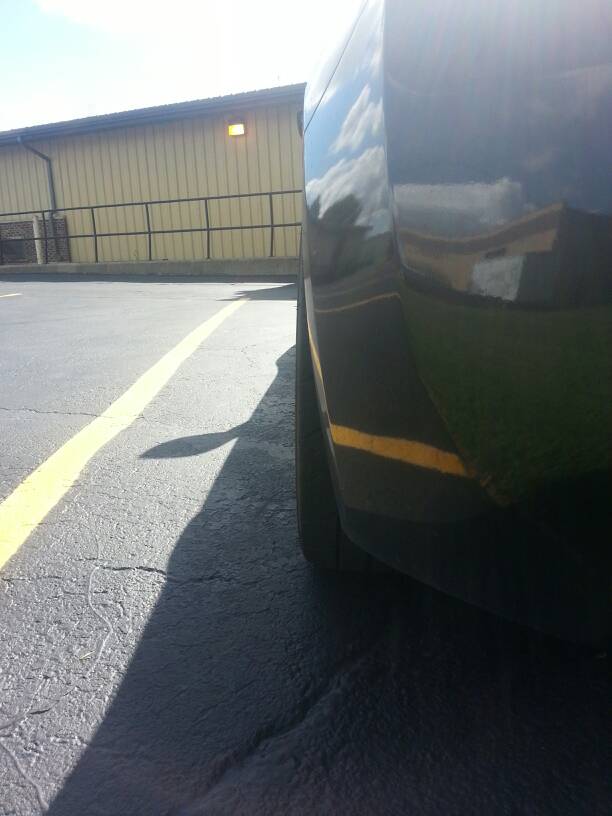

SO Im thinking SPC camber bolts it is. Ill send some pics in a second so you can see what Im talking about.
barabia 07-08-2014 05:46 PM
4 Attachment(s)
Attachment 84389backAttachment 84390backAttachment 84391frontAttachment 84392front

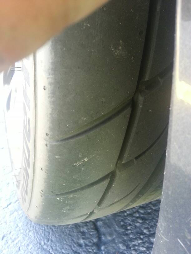

barabia 07-08-2014 05:52 PM
You can even see how some of the lettering is still present on the outside tread of the rear tire. Im ok with this Im just worried I might wear too much of the outside front when autocrossing, as even after some spirited back roads driving its wearing almost all the way to the sidewall.
vroom4 07-08-2014 05:56 PM
Your tire wear looks fine. If I wasnt so lazy Id post a pic of mine...but imagine that arrow completely gone.

Originally Posted by barabia (Post 1835632)
Its just that now that I have put this wider wheel/tire setup on. I can really tell that the back has a lot more camber than the front. Ive been looking around at camber plates and I would have no idea which one to choose and they're all actually pretty expensive...definitely outside this years budget since the tire purchase :o/
Like @vroom4 said, that outside wear looks just fine, especially given how soft the sidewalls are on that tire.
As for visually more rear camber, yeah, that'll happen when you lower a car. No camber improvement up front because of McStruts. So, when you lowered the car, you got more in the rear. Maybe also consider camber correction (lower control arms, offset bushings) in the rear as you move forward?
