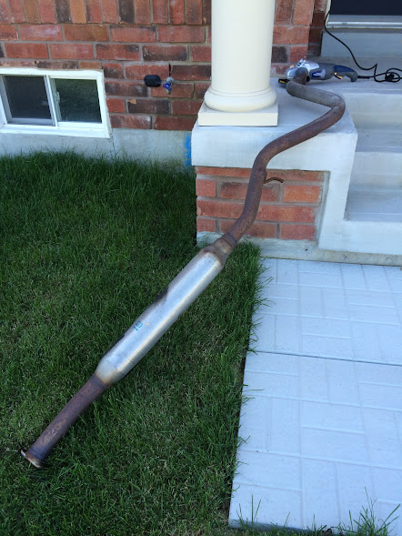

After only have the axleback for a month, I picked up the Nameless 2.5" resonated OP/DP combo with the high flow cat. I bought it off @BatStig who had already put a ceramic coating on it and only used it for 400kms. Now I wouldn't say I'm a perfectionist, but when I do something I like to do it right the first time. So before I put the OP/DP in, I went out and bought a racing jack, four jack stands, an angle grinder, and some VHT high temp exhaust paint.
https://lh3.googleusercontent.com/-O...9-no/Life++-+9
I removed the entire exhaust system from the header back. Since I drive in the winter, I wanted to protect the exhaust system as best I could. After one winter, the midpipe had a good amount of rust on it already. So I sanded it down to remove all of the rust.

While that dried, I installed the OP/DP combo. Jacking up the engine was very easy. I removed the single engine mount nut from the passenger side subframe, placed my jack under the oil pan, and lifted it up about 1.5". With the engine raised, sliding in the OP/DP was very simple.
Reading through the forums, I noticed there were a few people who had fitment issued with the Nameless OP/DP. This was another reason why I took everything off. Doing that I was able to focus on the connection between the OP/DP and the header. I used a brand new gasket and tested for leaks before putting the rest of the exhaust on (LOUD!!). Unfortunately I had a very small leak coming from the middle of the flange (furthest point from the two bolts). I wasn't able to tighten the bolts any further so I took the connection apart and applied a very small (1/8") bead of Copper Gold RTV. This got the job done and I had no leaks.
Putting on the midpipe and the axle back I took my time. I installed them both loosely so that I could align the tips perfectly. When I initially installed just the axleback, the tips were off just slightly but it still bugged me every time I looked at it. With the midpipe and axleback connections loose, I was able to align everything perfectly and tightened everything up without any leaks.
When I first drove it, I didn't drive hard as I had to put the VHT through its curing process. However, today was a different story. With both VHT paint and the copper gold fully cured, I took it for a good drive. With the OP/DP the sound level definitely increased. I would say it is perfect now. Still no drone at all and a very sporty/mature sound. As for a power increase it is hard to say right now. I disconnected the negative battery terminal to reset my ECU so it is still learning a bit. I definitely notice some more power in the dip but again it is hard to tell higher up.
Overall, I am very happy with the Nameless parts I have put on. Build quality way above anything else I have seen, fitment perfect, and amazing sound.

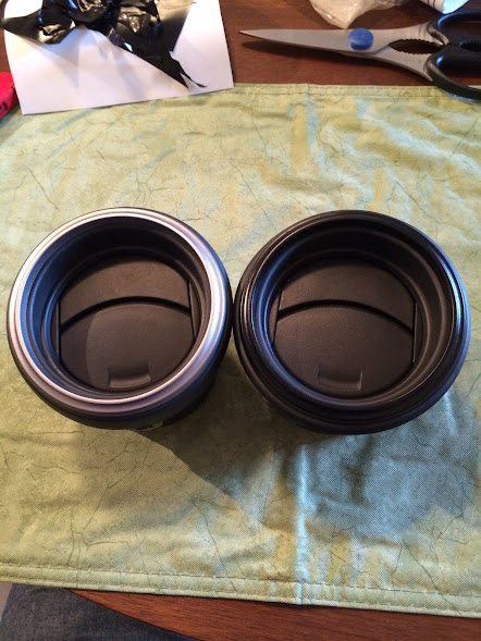

Here's a little teaser of what I have started this past week. Covering up all silver trim with matte black vinyl.
Before and after:
https://lh6.googleusercontent.com/-b...9-no/Life++-+8
