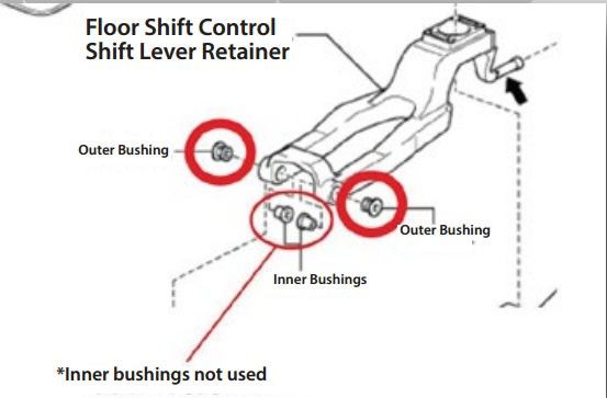

Brinks 07-10-2014 05:44 PM
The Twins don't have a "Front stay bushing" but they do have front carrier bushings.
http://i1283.photobucket.com/albums/...ps9cd60d38.jpg
