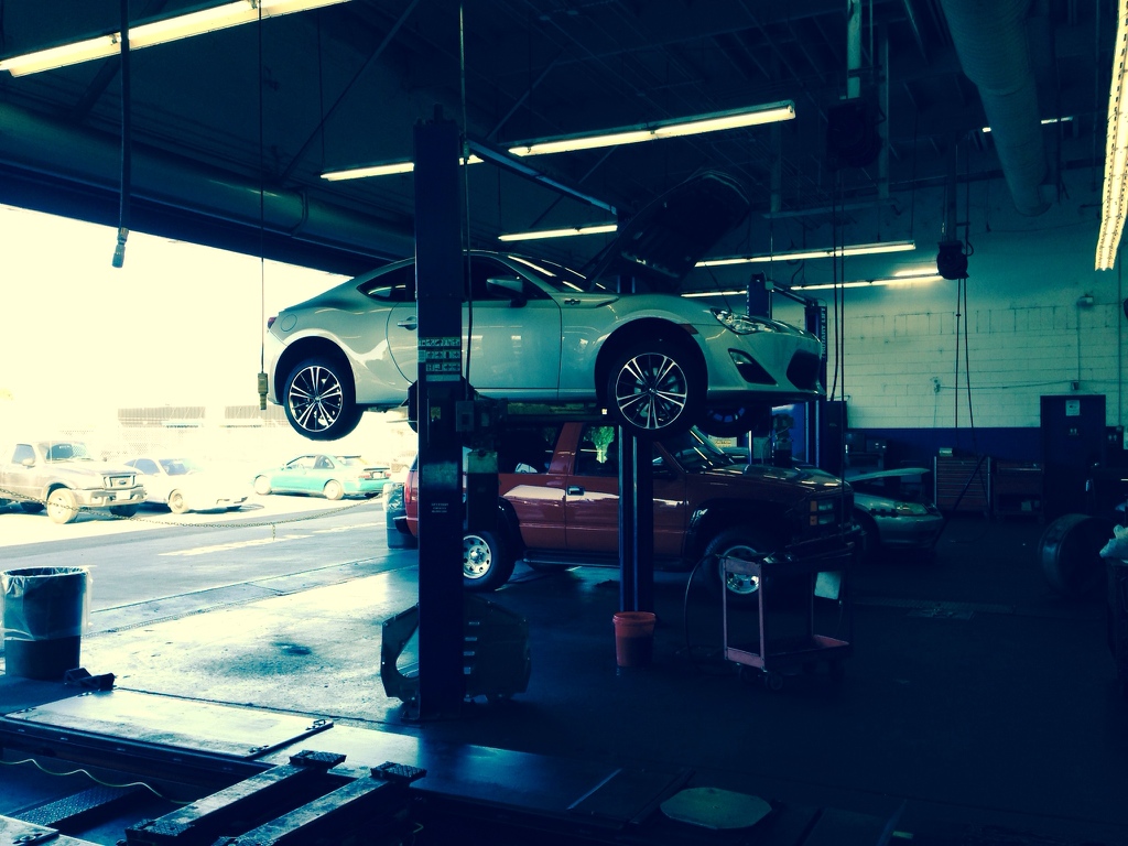

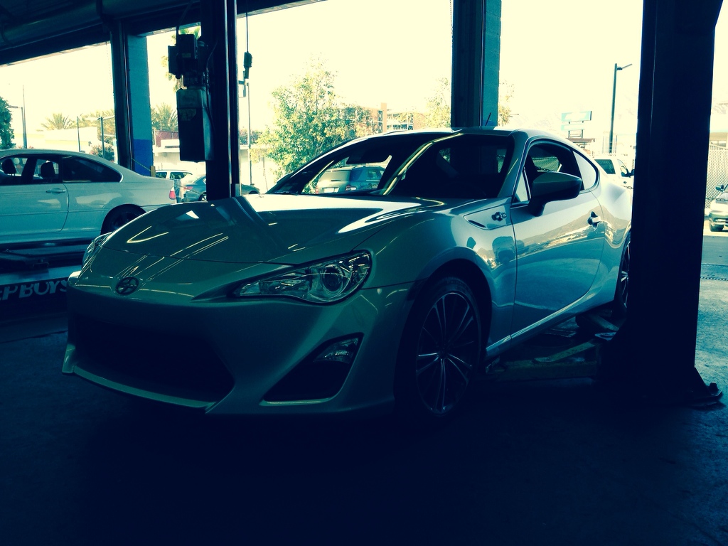

So today I pulled my car into the shop at work to swap out the fluid. Odometer at 1000.
I was so excited to feel the change on my gears with no success... I don't know if I used the right fluid... I know that's what it calls for... What have you guys used? Gears feel so crunchy!!!!! Help. My motors feels happy though!Attachment 82517Attachment 82518Attachment 82519
