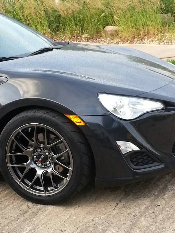

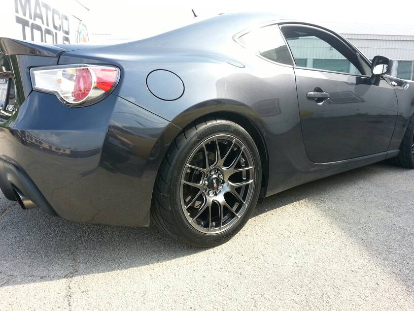

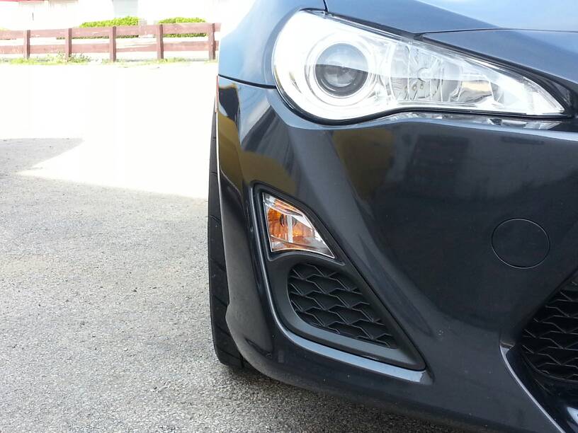

barabia 06-30-2014 08:40 PM
Well I decided to just go with some wider tires anyway lol. My wallet hurts but Im happy with my decision. Hankook Ventus R-S3 245/45-17. Cant wait to autox now!
Vampyre 06-30-2014 08:44 PM
I want to see pics of this. I am thinking similar setup.
barabia 06-30-2014 08:46 PM
Attachment 83709
barabia 06-30-2014 08:48 PM
3 Attachment(s)
Attachment 83710Attachment 83711Attachment 83712
tahdizzle 06-30-2014 08:57 PM
looks good.
