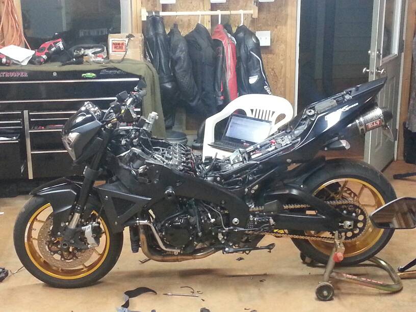

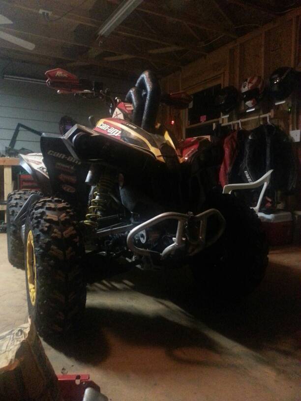

I started building atvs and motorcycles in my somehow always second story apartment in various places with a sears toolkit while all my shop equipment sat at my mothers house thousands of miles away. I ended up with a very fast suzuki bking, a ducati and a absolutely monstrous 100hp can am atv. Attachment 82275Attachment 82276Then I moved once more and was told I would be there a minimum of 3 years! That an eternity! I bought a house and a trailer and moved my toolbox and gear down from my mothers house.

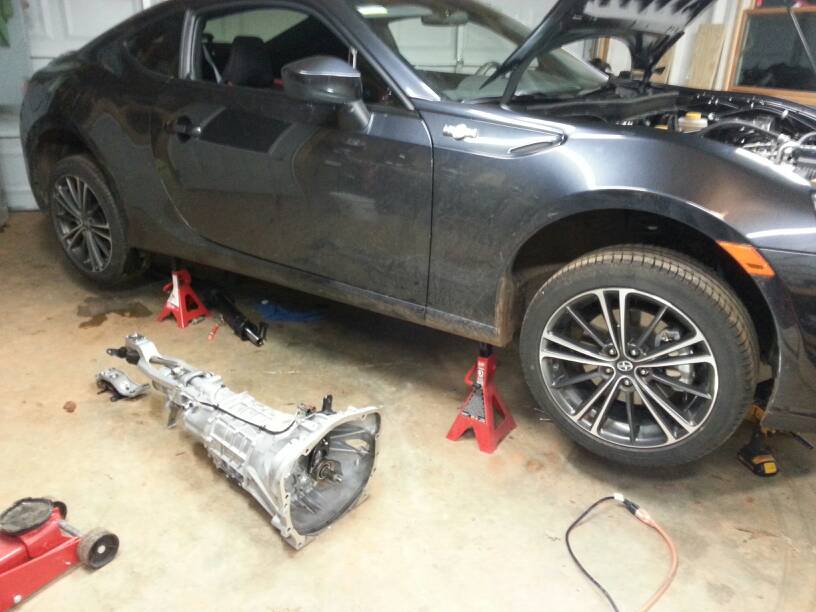

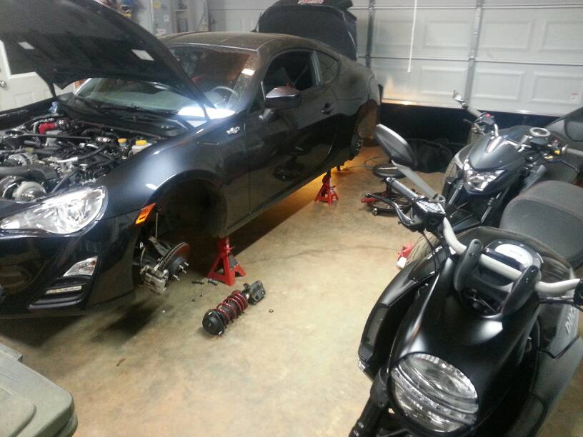

First thing I did was swap the clutch out for an act streetlite and a 6 puck sprung.Attachment 82281 Then i started dding the car as weather was getting bad and my wife likes my truck. When the turbo showed up I installed half of it. Lol. Literally. The fuel pump, intercooler and all piping were installed and the coolant and oil line where run but capped off. I drove the car all week like the that.
Sent from my SAMSUNG-SGH-I747 using Tapatalk

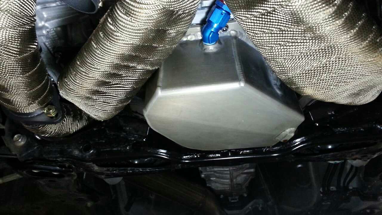

Reaper 06-16-2014 11:15 PM

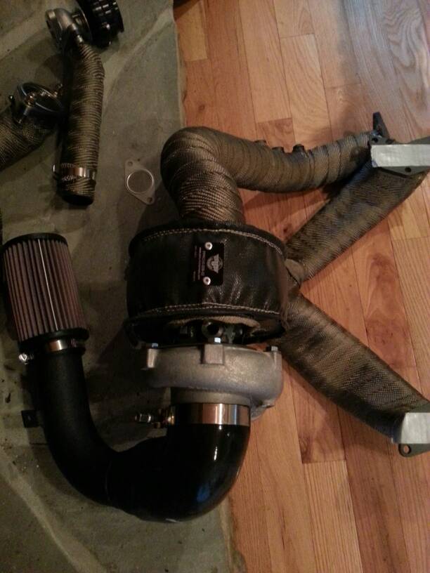

Attachment 82283 next weekend the turbo, manifold and injectors went in. Then onto the trailer to the tuner.

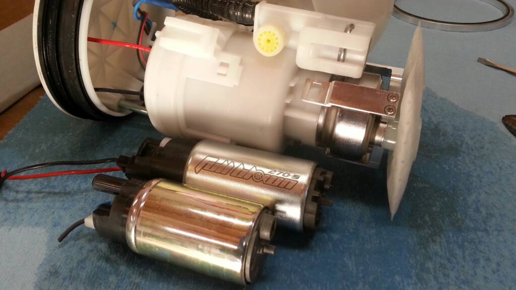

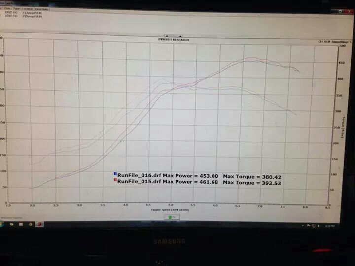

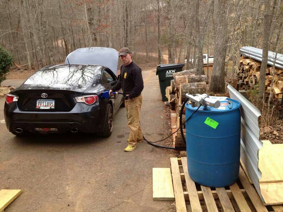

The goal was torque. I chose a gtx2867r a perrin overpipe and a fullblown dual 3 inch exhaust. I went with 550 injectors because I dont have e85 near me. Then we made thisAttachment 82284 Attachment 82287 so this happened Attachment 82286 I started storing 55 gallon drums of e85 at my house and ordered bigger injectors anf a walbro 485
Reaper 06-16-2014 11:26 PM
I had a weird high rpm lean condition. Thankfully I was smart enough to wire a wideband o2 into the factory ecm and my tuner made me a great custom map with a failsafe that saved my motor. I had a large change in e content and was pushing my fuel system a little hard.

The 1000s and the walbro 485 are in! My buddy just grenaded an ej25 over 400whp because the factory wiring died while using a 485 so mine was hardwired. Car made good power and seemed to be stable and reliable now. Then another lean condition. Wtf! Now an idle issue and a dtc. Now its running hot. Holy crap.
Hardwiring caused a po230 code(fuel pump voltage)
Idle issues were because a walbro 485 hardwired is too much for the factory regulator to handle with rail pressures over 70psi. Both base fullblown fans died on the dyno. The no longer sell the kit with these fans.
I got it home and removed the upper radiator mounts and trimmed the factory shroud violently until it fit. Somehow.
Car drove pretty well and made a lot of torque spooling nicely. But still had some teething problems. Mainly the fuelpump and po230 code. With a check engine light on you lose your cruise control by the way.
I called lj at fulblown and walbro. Turns out when I initially checked my pump voltage it was at 8.6 which I thought was from resistance. Turns out the pump is voltage controlled by the ecm. I ripped out the hardwired relay and the dtc is gone and the car runs buttery smooth after a tune adjustment.

I have a plywood box over it now. that was the first day I brought it home.
