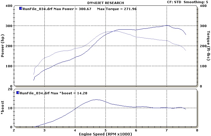

I'm not running the Greddy Turbo kit anymore but this was the tune Full Blown did for me on E85 @ 14PSI (max on the stock Greddy actuator). My 91 pump tune was around 245whp.
Attachment 82333

Some decent power on E85 @shiro...What kit you running now why switch,
could have just run a little bigger turbo than a T518Z on the same set up.
I guess R/T Tunning maxed out the Greddy Turbo kit on pump
