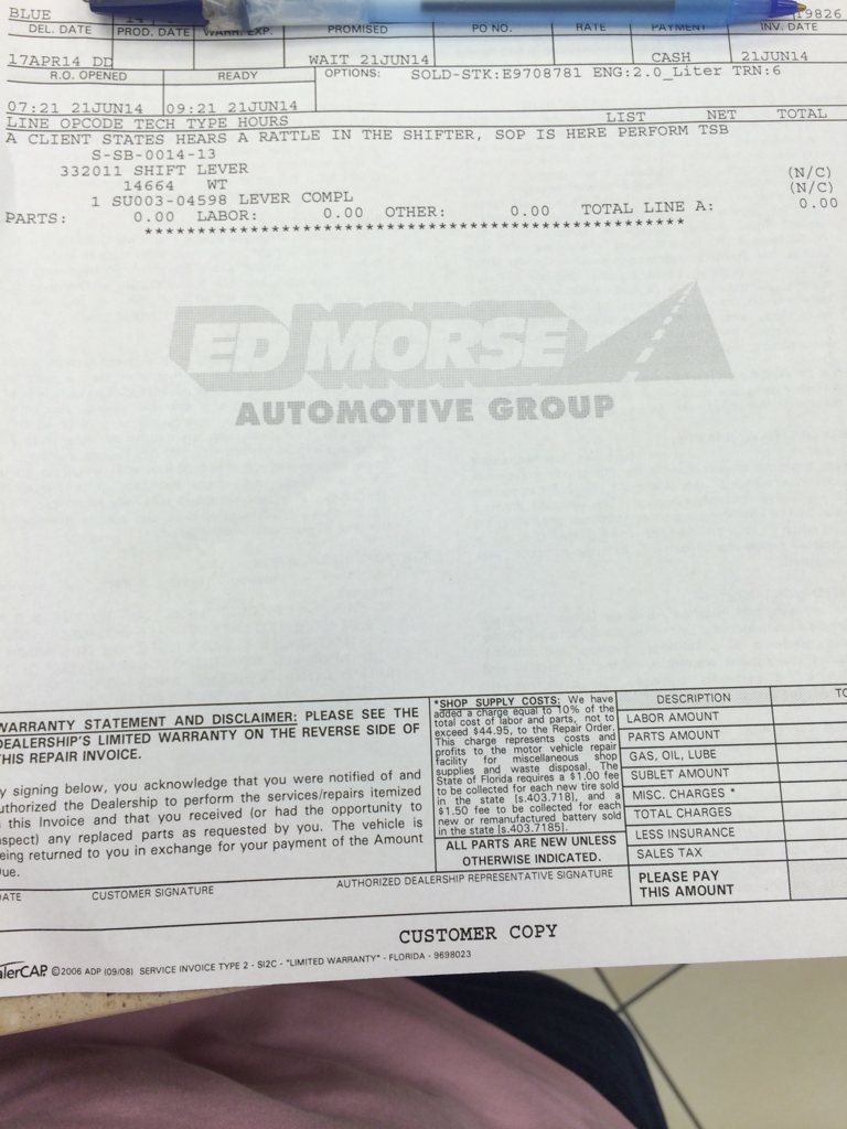

becauseracecar1 06-21-2014 09:54 AM
Attachment 82745
Got the TSB done and now it rattles 1st-6th gear :( FML
