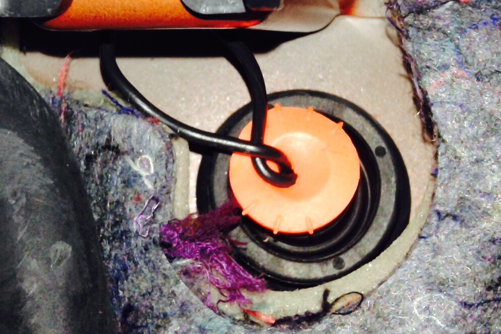

smbrm 05-21-2014 01:51 PM
A modified ear plug with a pull wire seemed like a cheap & cheerful solution!Attachment 79474
Harvey 05-21-2014 05:34 PM
Not bad the ear plug.... I'm currently printing a custom plug with my solidoodle 3D printer!
subiestyle 05-21-2014 06:21 PM
That's a fat ear plug. I used 2 to plug mine up with a cap to top it off.
