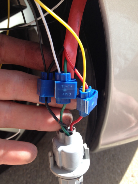

The kit comes with three wires: a ground, a wire for the white led and a wire for the blinking function. You wire the ground and white led into the stock side marker wires after you remove it, and then wire the blinking function into your switchback.
Or you can just wire all of them into the switchback like I did. The wire tap connectors in the picture actually didn't work because the side marker wires are really small diameter. I actually just took off the connectors and twisted and covered with electrical tape and it worked perfect Attachment 79078

It's been raining today, but I did the exact same with bullet connectors so I can disconnect quickly
