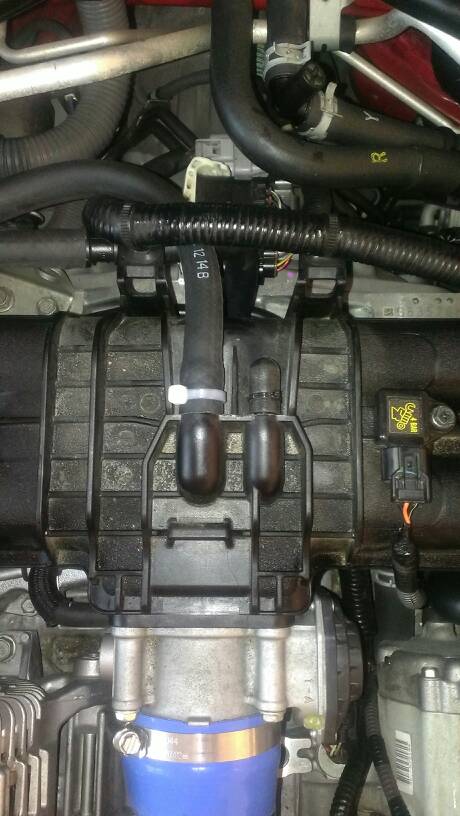

Under the intake manifold cover there are the two hoses. On all pictures I have seen there are two hoses, mine has one and one capped off. Any reason the one is missing and capped off? Thanks for any help I can get.Attachment 78466

yours is an automatic and the brake booster hose goes to the vacuum pump on the back of the passengers side cylinder head.
beforprez 05-13-2014 09:35 PM
Well as long as it's suppose to be like that. I'm good haha thanks
