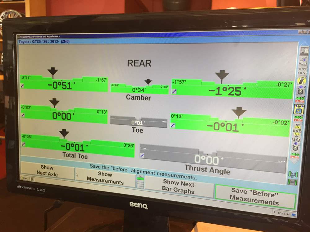

And (This is where the surprise is) REAR -0.5 Deg on the left and -1.24 Deg right
(Zero Toe)
That's pretty fu$kd up lol
Due to time limitations, I had to leave, but the manager assured me that this difference at the back is negligible, and that the only way they can adjust it is if they shim it.
He said that shimming is not the best long term solution, and they tend to wear out...he recommended I buy an adjustable LCA.
Sav got pretty good results, with -1.4 deg camber at the front and -1 deg camber at the back.
Thanks for the help and advice Sav!
I am going to do some research on shimming to get camber and probably go in the weekend to get my right rear camber sorted.(From -0.5 to -1.1)
Take away from my experience today: Our 86's are bloody skew:confused0068:

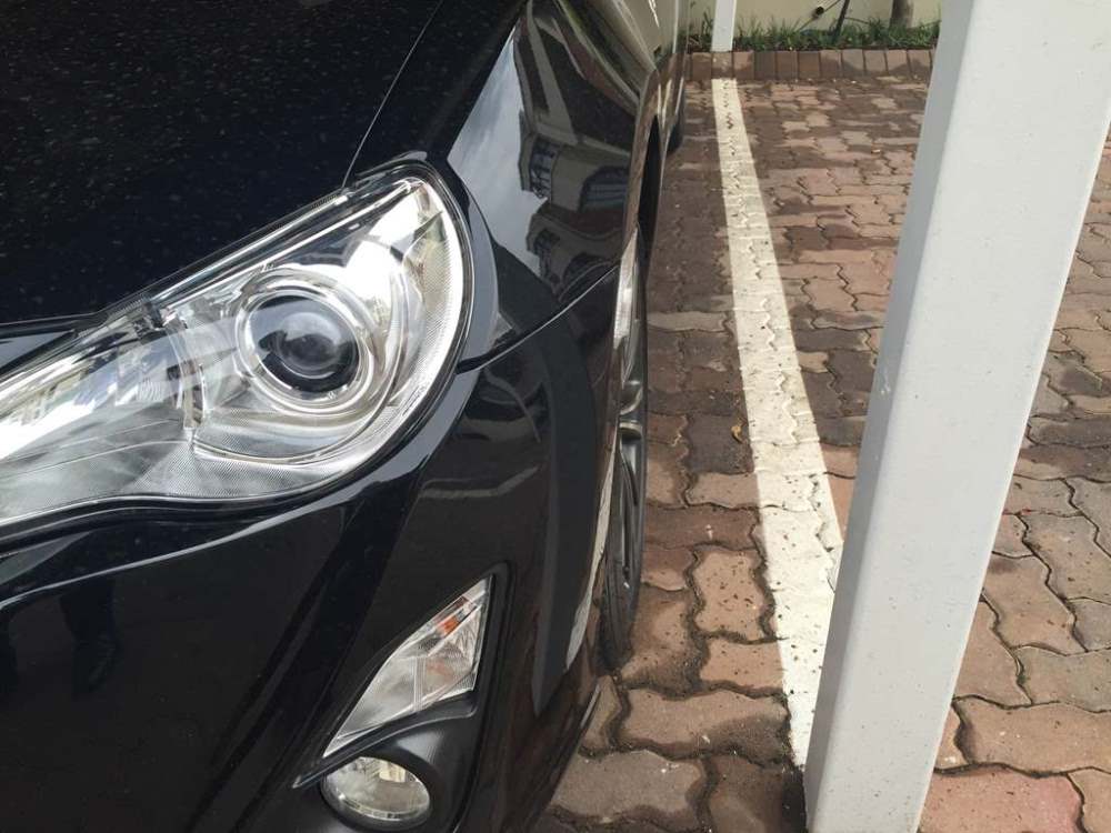

3) How the FRONT looks with -1.2deg camber
Attachment 123619
Attachment 123620

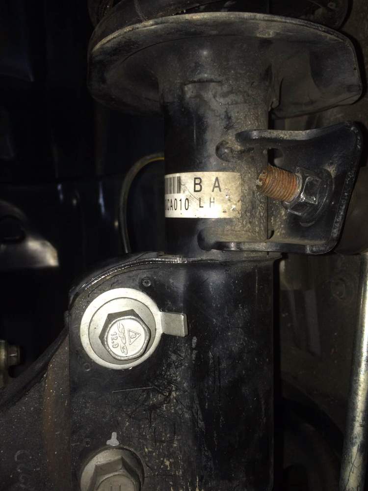

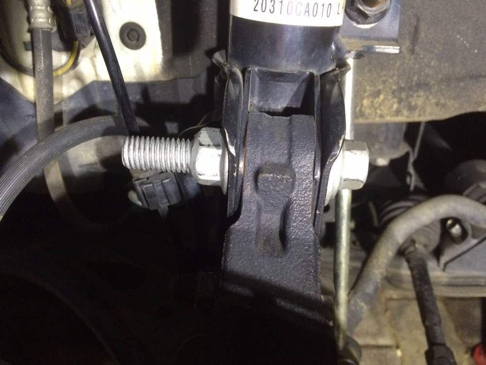

4) Pics compliments of @sav and @LostSalad who installed these Camberbolts themselves, Respect:party0030:
Attachment 123621
Attachment 123622
Attachment 123623
