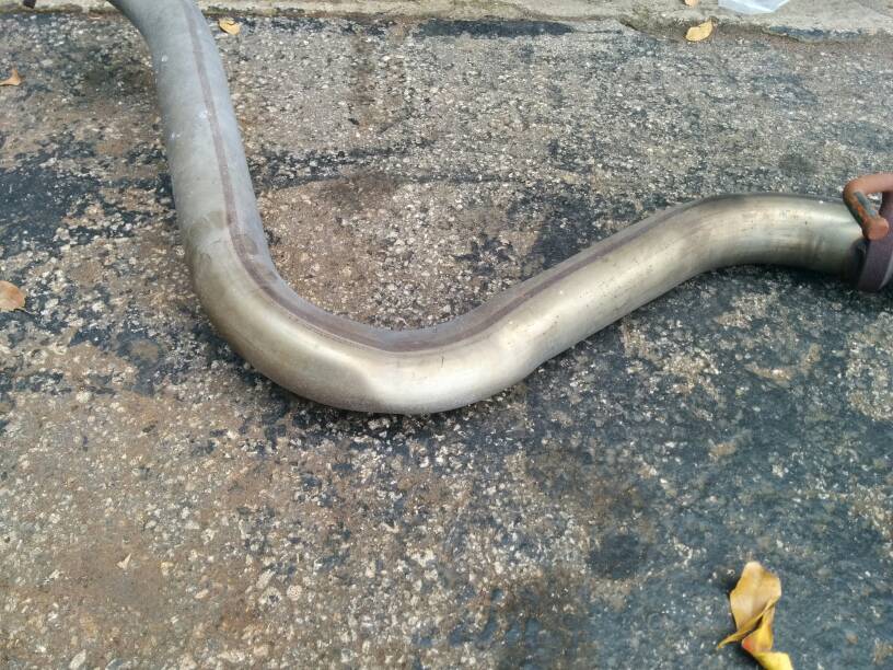

Rican_D 05-05-2014 02:56 PM
Attachment 77480 just to help with visuals, look at this choke point, and this at this mid pipe.
