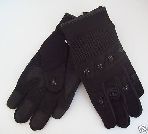

Man, have I been there before! Do it as soon as you get home, tighten the bolts up the next morning, and you'll be fine when you head out again. I've given up a lot of sleep and almost as much skin in the last 50 years to make things like this happen, and I'm sure my family didn't miss me that much at the dinner table.
Just remember that anybody can steer the ship when the sea is calm, but greatness rises in a tide of adversity. This is why God made Kevlar mechanics' gloves.....
