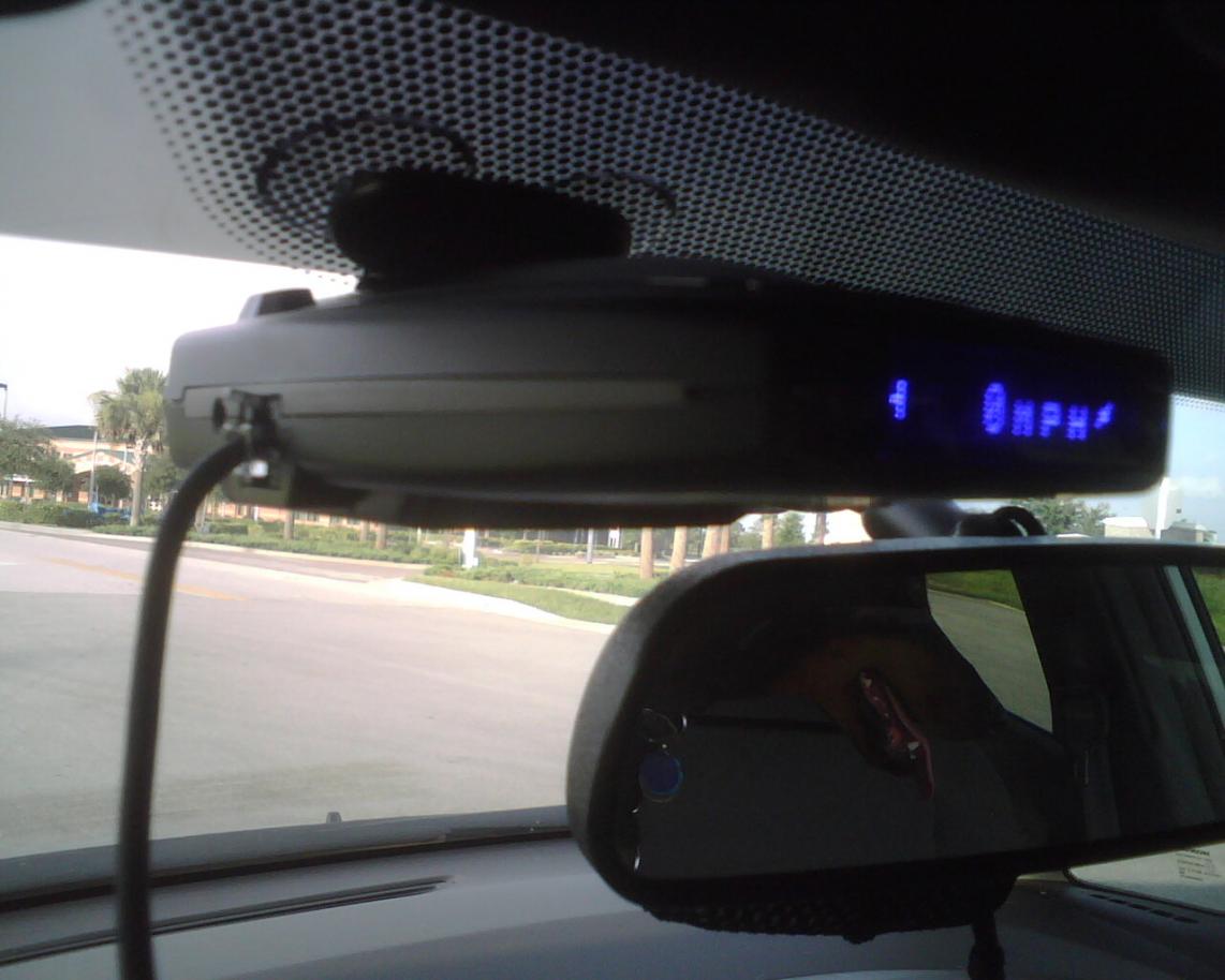

But I will answer you honestly this time. I have installed these detectors a couple times and run a 9500ix in my camry and the Escort 9500ci in my FR-s and love it! :)
Option A ($$): You could possibly mount the radar detector behind the mirrow limiting the visability inside and outside. **it shouldn't be as noticeable from the outside with proper adujstment but remember with putting a radar detector too high an impeed on the sensitivity of Laser (light) but NOT radar. Buy the smart Direct Wire SmartCord cord and wire it into your dome light OR run it down your driveside piller to your fuse box and put an instant fuse add. You can mount the smart box and indicator light in a convenent location for an easy mute and indicator. You can put an optional [ame="http://www.amazon.com/Littelfuse-FHM2BP-In-Line-Fuseholder-Protective/dp/B000COA31K"]mini inline fuse[/ame] if you decide to connect it in the dome light (maybe mount the smart box in the ceiling too).
Attachment 74946

@shiro,
thats the exact location of my detector!(8500 x50 black)
Op, its hardwired into the domelight/headliner. If you pick up a separate cord(and suction cup), you can just swap detectors back and forth from cars without having to mess with the 12v everytime. Plus where you're in a sketchy area, you can easily remove it. When I take my detector out, there is about 2-4 inches of wire that can easily be tucked into the headliner, so no one would know its there.
