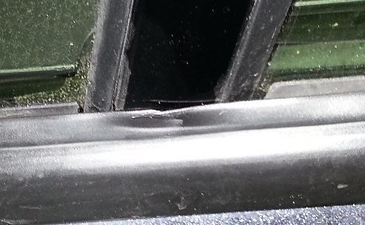

So the metal pillars on the window of my scion frs had rust after one winter. This is due to the window sill trim rubbing against the metal pillar and leaving bare metal exposed to salt and moisture.
I had both pillars replaced by Toyota but decided to get a shop to install some clear bra on them to try and prevent it from happening again by protecting the painted metal from getting rubbed by the window sill trim.

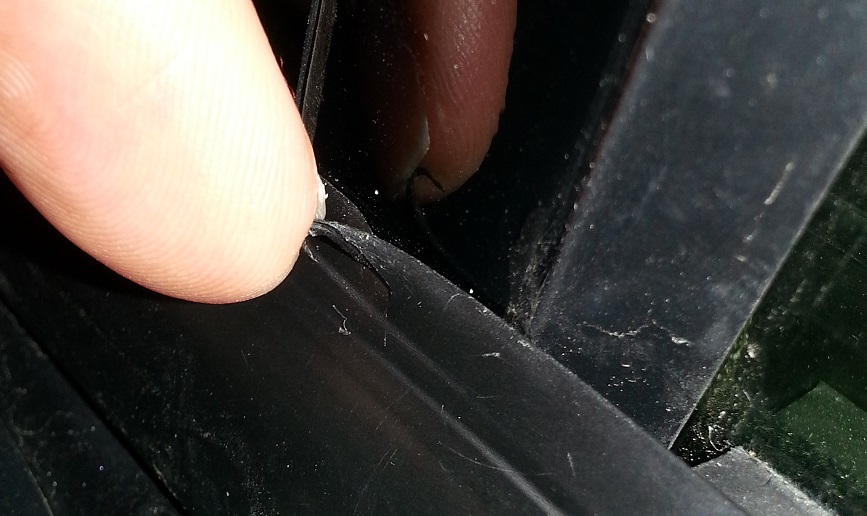

Unfortunately the shop did not do a good job and the clear bra doesn't extend below the window trim. On top of that, the shop caused a tear in the window sill trim that I am concerned is going to get worse as it flaps in the wind pulling on it more. I argued with the shop, but there is nothing they can do.
Will the tear in the window trim be a problem? And if so should I try and get it replaced?
Should I also remove the clear bra as I don't think it is going to be useful?

I don't think it causes any problem...
cycleboy 04-17-2014 10:44 PM
I'd be unhappy with the tear for sure. Not sure if it'll cause further issues, but it seems like it could (easier for whatever to get in there, noisier, ???).

Yes, I definitely agree with you. I love this car but having to deal with rust 6 months into ownership was shocking. Even replacing the parts are only a temporary solution as the rust will come back after next winter. The window sill trim should not be rubbing on the pillars where it strips the paint, as it is a design flaw.
Don't know what I'm going to do about the tear, might just wait and see if it gets worse. If it does I will have to get it replaced.
