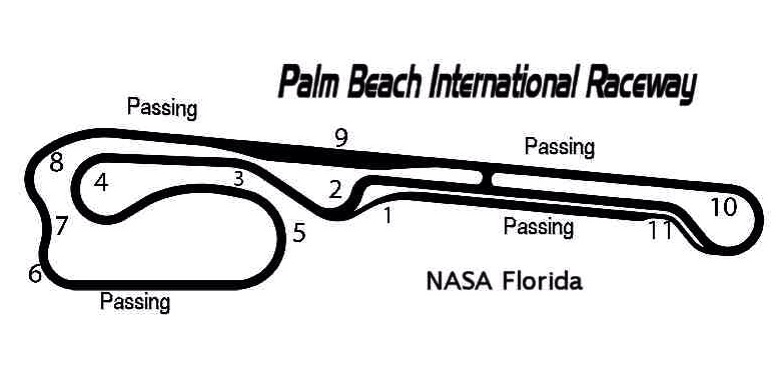

Do you guys think I could get away with running the stock brake pads and fluid at PBIR(palm beach international raceway)Attachment 74459

Braking for 10 is rough. Fluid I don't know why you'd bother running stock, fluid is cheap. Pads probably if you pay close attention to the pads behavior. May not get whole sessions or the whole day before they are glazed though.
