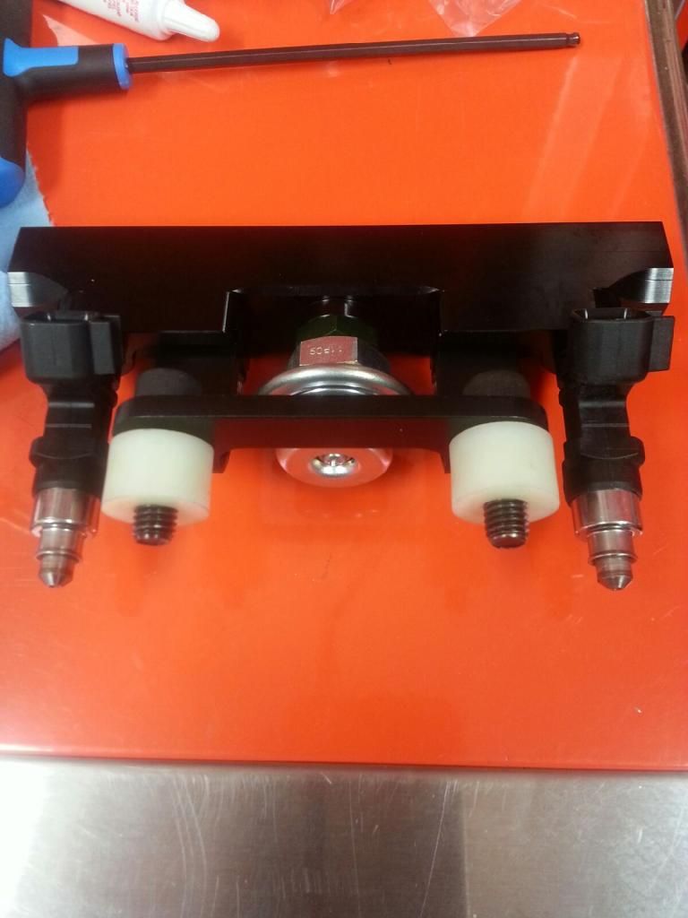

In other news I popped these bad boys in yesterday and finished running my coolant lines to the turbo.
http://i1353.photobucket.com/albums/...s4cc76697.jpeg
