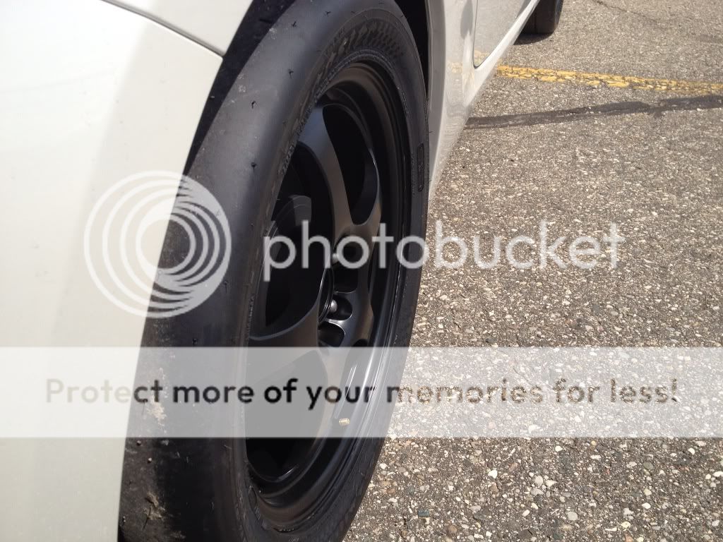

A couple quick notes from this weekend in a BRZ:
1) A 245/40/17 A6 fits with room to spare on a +42 17x7. If Hoosier made a 255/40/17, I wouldnt be afraid to try that.
2) The same set of 245s (brand new, wrapped in storage totes) fits in the back seat area with room for a driver, passenger, and as much stuff as you can cram in the trunk.
3) The car is wonderfully balanced stock and tends toward the loose side of neutral, especially in quicker transitional elements. Sweepers are blissful. Slaloms could be improved, but are great for a stock car.
4) OEM crash bolts and a front bar will be magical. (I think)
Any pictures of the 245/40/17 mounted on the 7 inch wide wheel?

Sure:
http://i354.photobucket.com/albums/r...t247/tires.jpg
At 35 psi on concrete, I started to get some serious edge wear on the fronts. It seems better at 40 psi. Transients are also much crisper.
