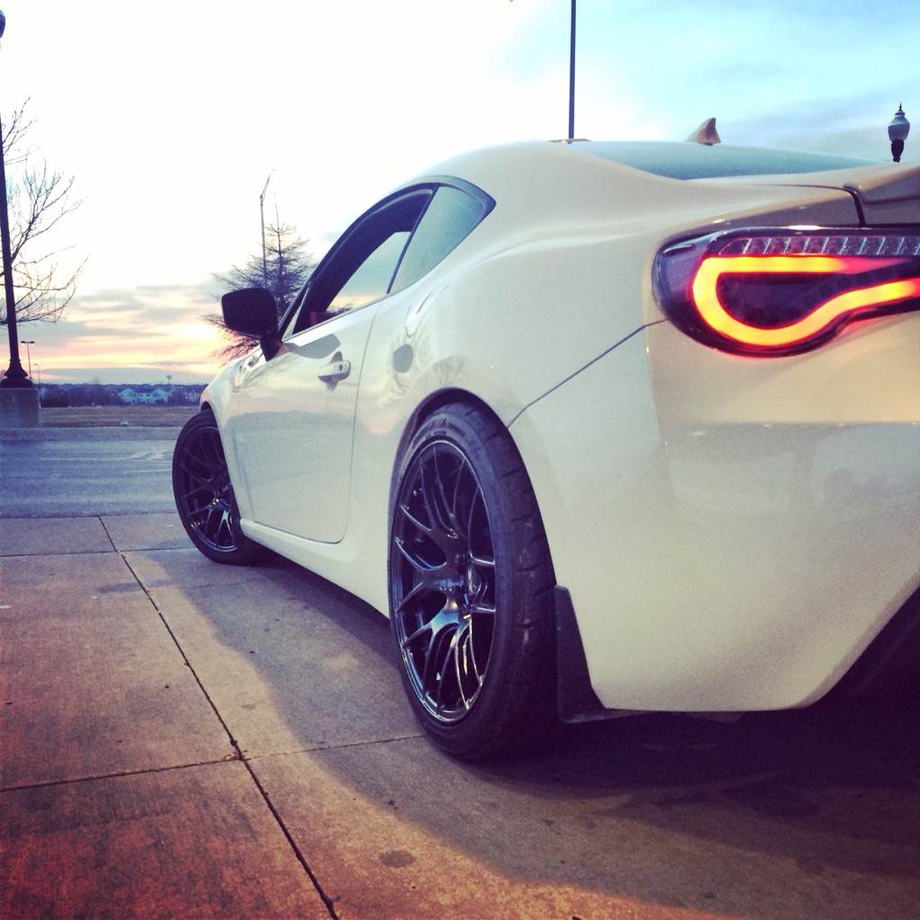

natesparxxx 04-08-2014 10:02 AM
Attachment 73575
I only rub on hard bumps and turns at a decent speed.
