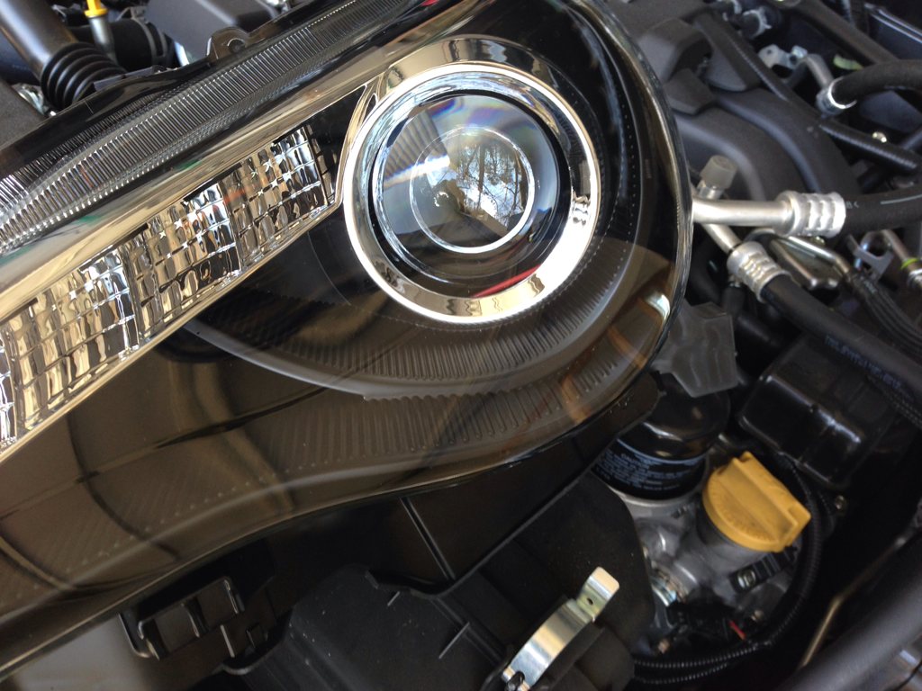

Should I be able to see the wires through the housing?
Attachment 73229
Mooseknuckle44 04-05-2014 04:27 PM
I'm no expert, but l've NEVER seen the wires thru any headlight housing. OEM or aftermarket.
OURO3OROS 04-05-2014 04:28 PM
I yanked them through the grommet, and it helped a bit, but they're visible up close. Heat issue down the road?
beaver_scott 04-05-2014 06:14 PM
My winjets were the same as were some other winjets I have helped to install. When you remove the bulb access cap you can pull the wires back and out of the field of view.

To the OP: When you stand "above" my headlights or look over them, the wires are showing. I need to adjust my Winjets so that they aren't uneven and pointing at the ground today, so I will try to pull back the wires a bit. So I would say this is normal from Winjet, but you should be able to hide them yourself.
