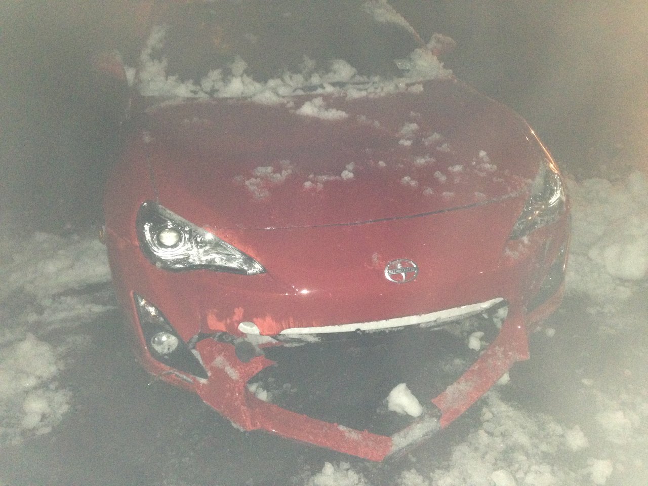

This is the result of our little mishap. The car hit some snow and the bumper was cracked. It was still driving, just some minor damage. The fender liners were screwed up and the radiator is bent, but the car's still going strong.

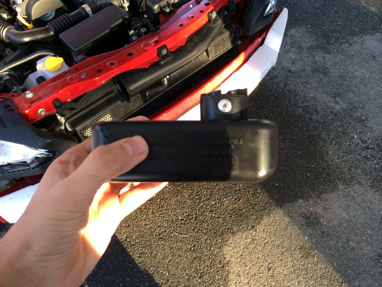

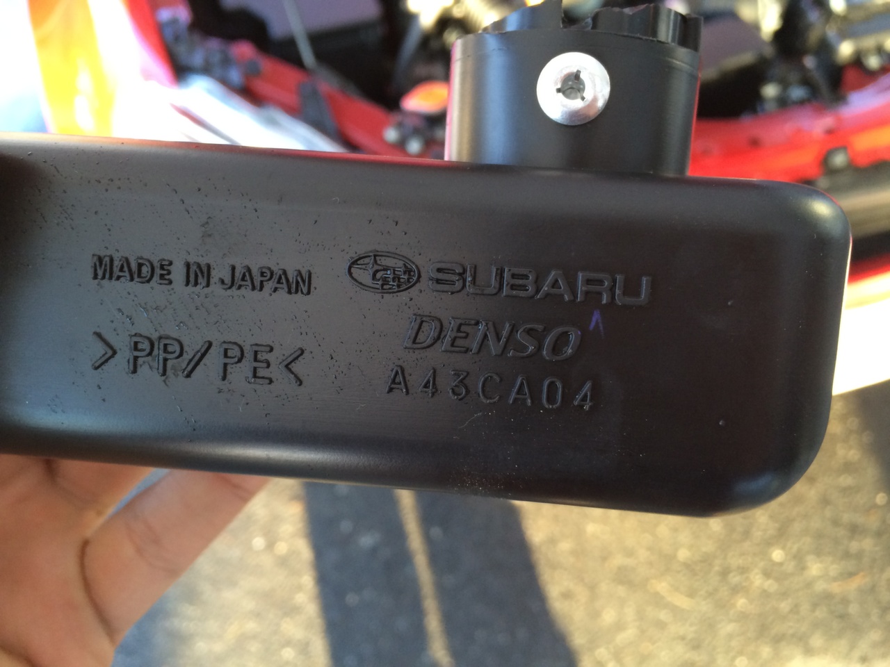

We need to figure out what this is. Is it important? Or can it be handled in the long term? Please let me know if you know what it is.

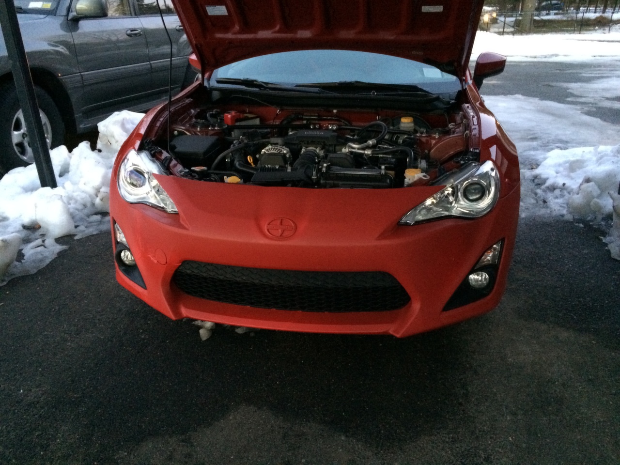

A couple of hours, some duct tape, and 2 cans of plastidip later, and this is the result. It held up for the week that it took us to get a replacement bumper from our Toyota dealer.

It's a resonator for the intake. I'd just plug off the hole and call it a day. It won't hurt anything.
Thanks! I'll let him know. Do you have any suggestions as to how we should plug the hole?

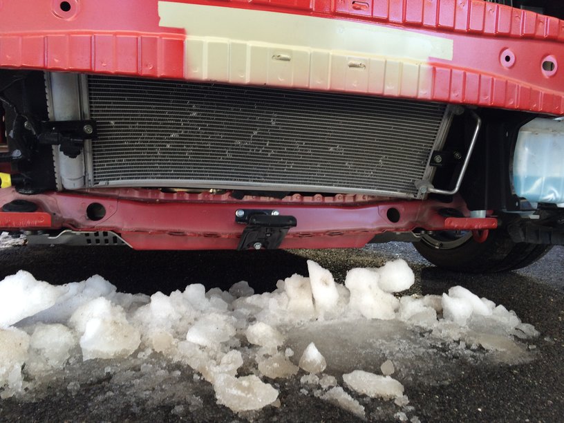

Also, would you be able to help me out with this.
Attachment 70860
Is it safe to drive the car, if the radiator is bent like that? We will of course be getting it replaced, but the car needs to be driven for the time being.

as long as radiator did not leak, it should be ok to drive. check any leak first
Dipstik-sportech 03-16-2014 11:21 PM
That's the ac condenser and if it leaks you'll only not have air con

Okay cool. No leaks, so we're good :w00t:

mid_life_crisis 03-16-2014 11:39 PM
Looks like a piece that hangs below the snorkel. Instead of plugging the hole, you might consider modifying the snorkel to gain a touch more high rpm power. There`s a thread for it somewhere. If you`d rather plug it, you seem to have a knack for duck tape. Stick with your strengths.
