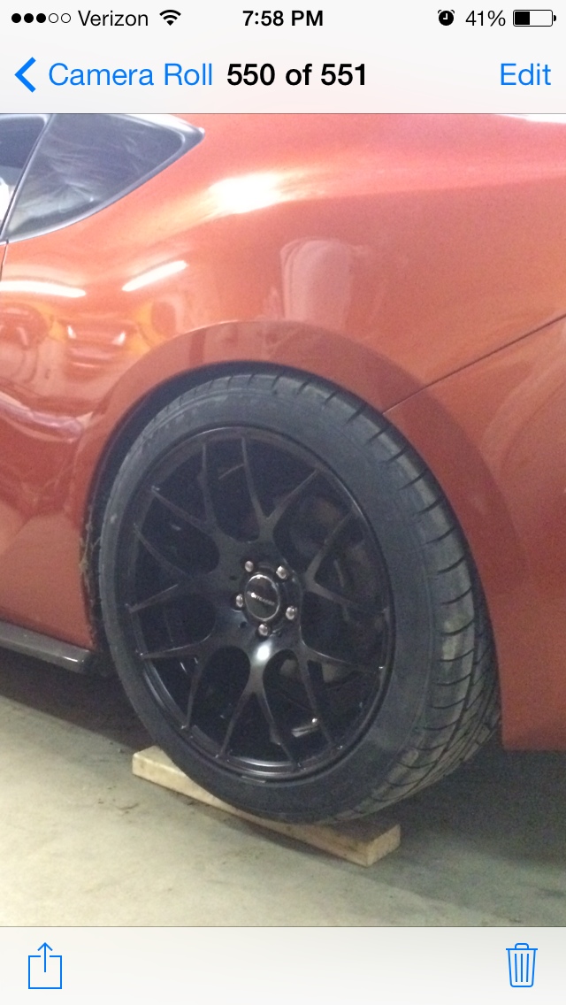

Lisak6841 03-16-2014 01:13 PM
Attachment 70795
Only photo I have as of now, I will take more from the side later on, and off the block.

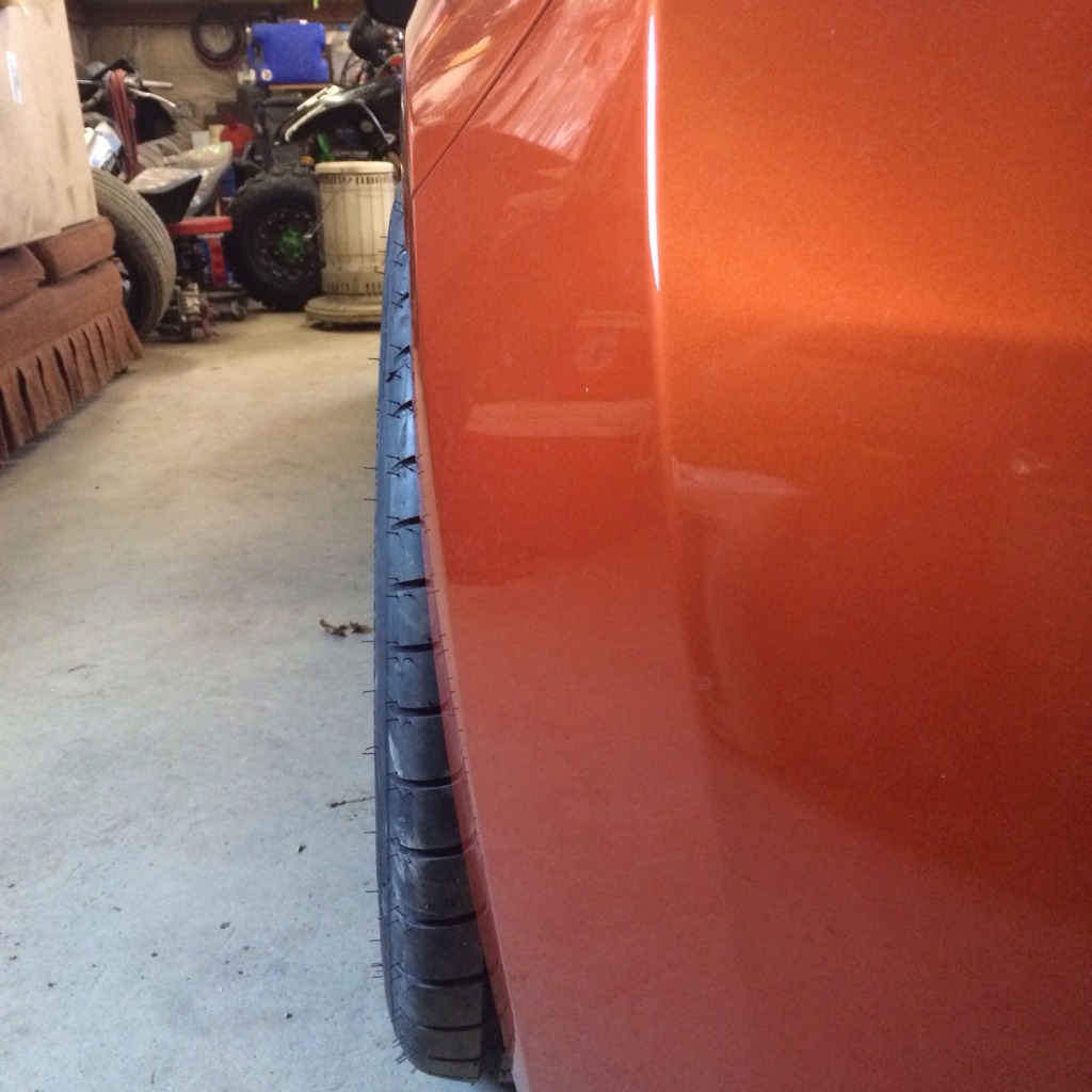

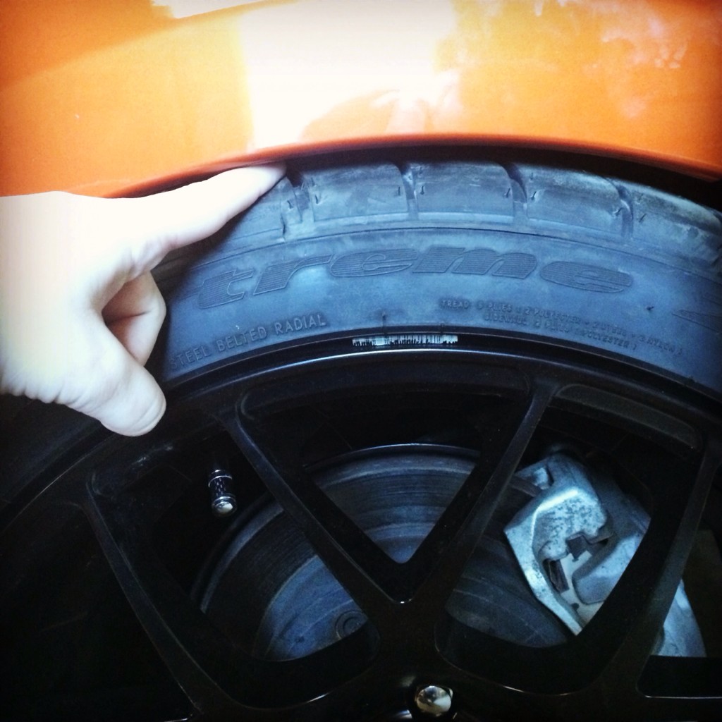

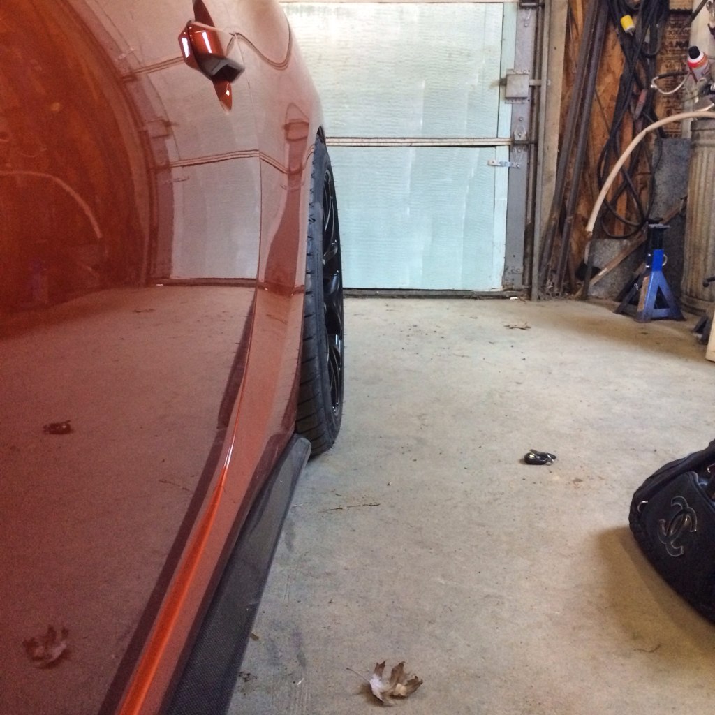

Lisak6841 03-17-2014 03:33 PM
4 Attachment(s)
Originally Posted by Vten (Post 1605305)
do you have any rear LCA? a little bit more camber would help without messing up the fender..
also do you have more pic taken from the rear so we can see how much the tires poke out ?
Attachment 70990Attachment 70991Attachment 70992Attachment 70993
Vten 03-17-2014 03:50 PM
wow that's really close tho ....I would go with a narrower tire such 235/40 or add the camber on the rear using an LCA , as I would avoid to mess around with rolling the fender at all cost .
my new set would be using the 225/40 bfgoodrich comp2 tires on a 9.5 wide wheels and +30 offset...a little stretch for most ppl here :P
Go bucks!
Lisak6841 03-17-2014 03:56 PM
I just hate to buy new tires since these have never even made it out of the garage. This will be my $500 mistake.
executivekoala 03-17-2014 04:23 PM
You cant really roll these fenders, they already have a roll. I know this because mine were rolled, i got millimeters of extra clearance. just add -2 degrees of negative camber and 0 toe and you should be okay and make the rear more stable around corners. 0 toe will wear the tires less.
