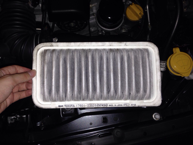

Can please advise me which direct should the air filter be ?
Attachment 70640
A lot people told me the wording should be facing outside but I can't get it to fit in.

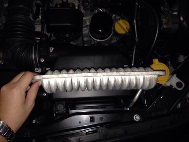

Attachment 70638
I only can get it to fit this way (wording facing inside, longer fin outside)
Attachment 70639
Please advise thanks !
Shagaliscious 03-15-2014 07:53 AM
It looks like you are correct. This picture shows the bigger side facing out.
http://www.grimmspeed.com/content/im...iy/Figure5.jpg
vincent201089 03-15-2014 07:54 AM
Don't remember exactly because I change mine to perrin intake. However, look at the first photo, you will see 3 corners have same round shape and the other which is bottom right in your photo is a little different (kinda square).
Line it up with your air box (if I remember correctly, 3 close corners and 1 open is for the 4th corner) If you don't do it right, there's no way you can put it together.
Hey. Found this, finally! That 4th corner has to be lined up with the bottom left on your air box.

So does that mean the long fin facing outside, wording face inside ?
The filter can only fit one side right ?
FrsDuke 03-15-2014 09:17 PM
Just trust the corners
nelsmar 03-15-2014 09:47 PM
Right above where it says Toyota there is a notch. There is one on the other side as well if you look inside the airbox you will see tabs that go in the notches.
