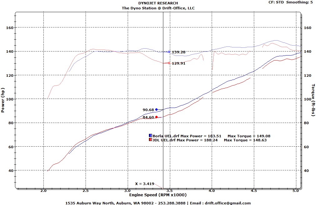

It's been awhile and someone reminded me via PM that I had yet to post the results of the UEL shootout from last year (yes, we've been busy!) so without further ado, here are the results...
Attachment 70423
Readers' Digest Version ~
All cars were 6MT, 92 Octane and most had exhaust systems, sans the vehicle with the JDL UEL which only had a stock exhaust system and an AVO Panel Filter (Dry)...
As you can see, the results are all fairly similar given the variables;
Similar Octane
Similar Tuning Philosophy
Similar Exhaust Components
That being the case, the two two performers will then be JDL and Borla in this case :
Attachment 70424
So the question now you have to ask yourself is what would be more important to you - the slightly better bottom end torque or the better top end performance with matching torque? Feel free to form your own assessments!

Drift-Office 03-13-2014 05:03 AM
The results do not take into account the following :
1) Price
2) Price to Performance Ratio
3) Quality
4) Fitment
It only takes into account the yields that we have attained thru the same dyno with the same tuning process with the same fuel... :)
