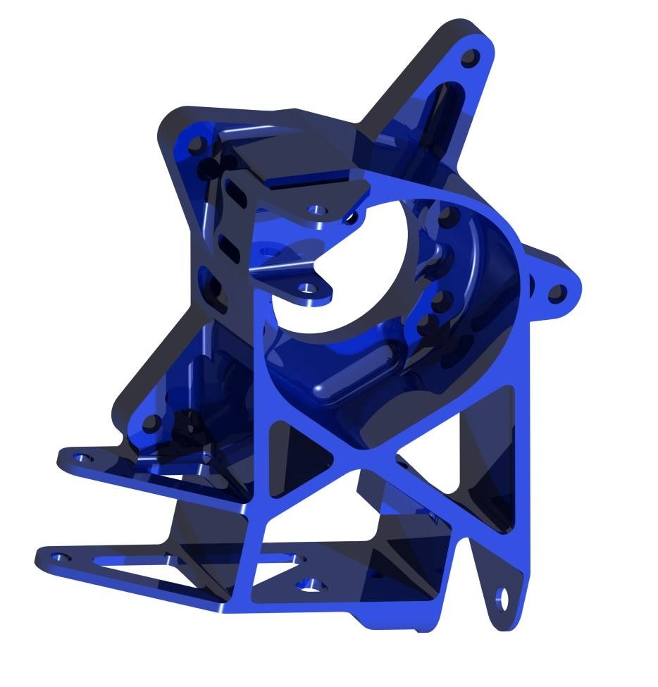

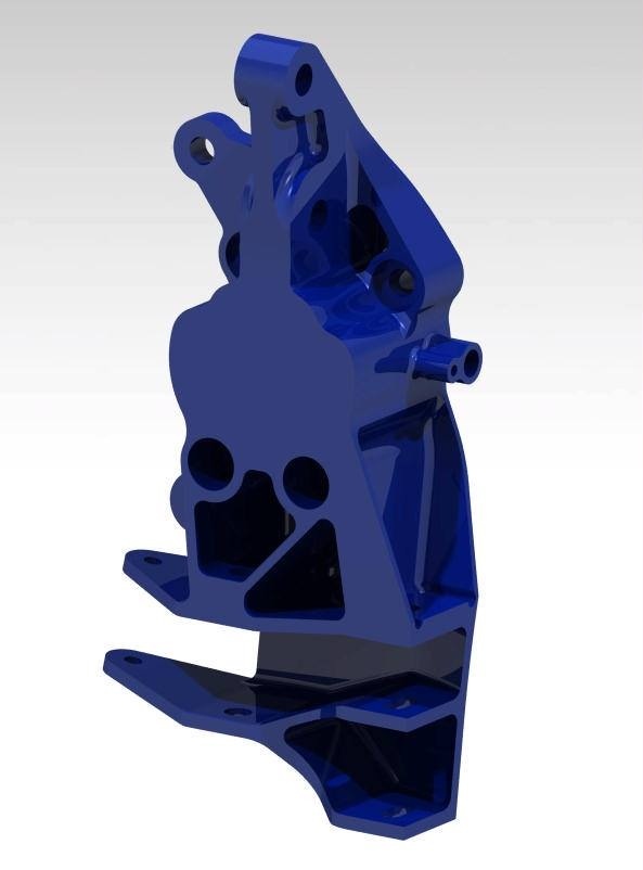

From Wisefab's Facebook:
Front and rear aluminum knuckles to go into production. Here are the prototypes.

What's different about them? Changing any geometry?
Shit Luck 02-25-2014 12:00 PM
fronts change geometry and allow for more angle.
rears allow for dual calipers as well as geometry changes i am sure.

Ryaquinn 02-25-2014 02:54 PM
They allow for increased steering angle and roll center correction.
