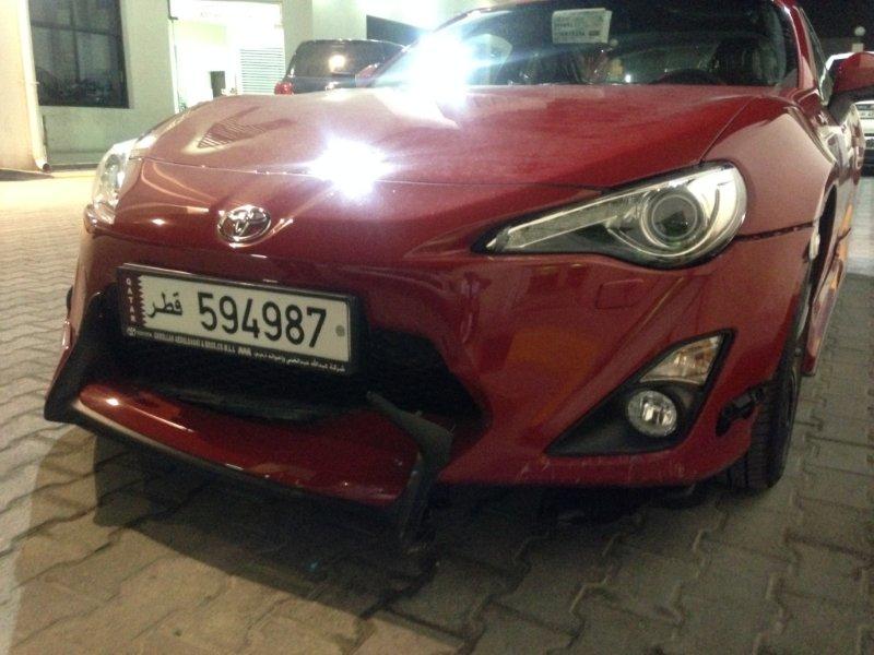

my car ran into a small pile of rocks off road and along with my heart, it broke some other couple of things.
To cut the long story short, toyota will replace the front bumper, aero bodykit parts, AC condenser grill (was dented), wiper wash reservoir (was damaged), front left headlights (dont know why), bottom plastic covers and panels, engine cover and the related accessories.
The supervisor told me that the front subframe was misaligned at about 0.5 inches, and as this subframe, unlike ordinary sedans, is NOT bolted but welded on to the chasis, it will be pulled into alignment and not replaced. How true is this? Can the front subframe be replaced?
Also, after the accident, the steering had to be kept towards right for it to go straight. So they will carry out an alignment and check if the suspension needs to be replaced. And if required, will replace that as well.
Will just aligning the subframe cause the car to be unbalanced/ will there be bad stress loading that can result in more damage in the future?? Kindly advice regarding this. A bit worried thinking about that possibility.

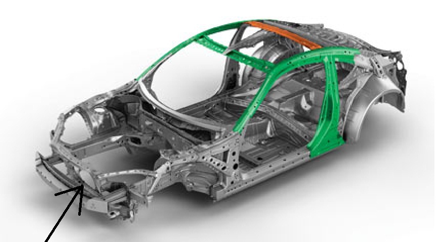

The part that Im talking about is the left-most (frontmost) beam in the pic you posted...the one behind the bumper. They showed me the top view pic of the beam and said it had gone half an inch out of alignment in the impact, so will be pulled back into alignment.

Attachment 67292
Thanks...Im talking about the above part of the frame.

Riz 02-16-2014 07:07 AM
the red beam to the left in the picture where the front end of the A-arm (yellow) is connected to is what I am pretty sure is bent.
