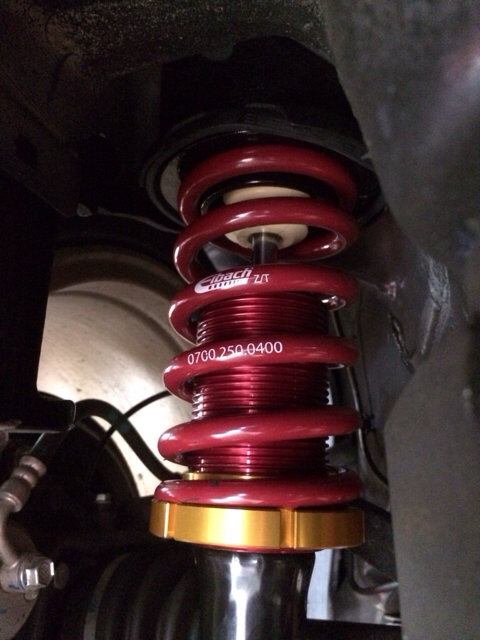

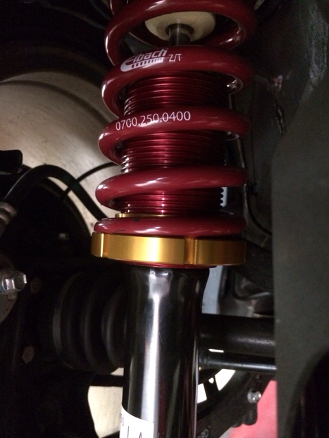

Installed the ground control coil over sleeves with Eibach springs on my FR-s. Front end was no problem with plenty of adjustment room. The rear, however was riding 1/4 inch higher than stock with the spring seat set as low as it will go. Brought the car to Darin and Chris at West End Alignment for corner balancing and even after several calls to GC we could not figure out why the car was sitting so high. We eventually got the height down to 1/2 inch below stock,by relieving all the suspension component binding but it seems odd that this would be the lowest we could get it. The sleeves extend upward from the spring perch by 3-4 inches. GC offered to send me some 6 inch springs ( existing springs are 7 inches) to rectify the problem, as they said no one else has had this problem, and it appears I assembled the kit properly. I would rather not lose the travel afforded by the 7 inch springs. Any suggestions as to what might be the issue?
Wolfking 02-12-2014 05:58 AM
Pics or it did not happen! Which Eibach's came with the kit?

Attachment 66917Attachment 66918Attachment 66919Attachment 66920
I have 375 in front and 400 rear.

Other people have complained of the same issue on other setups, that ended up being their top hat was installed upside down. Not saying that's the case here, but worth checking.
Kodi 02-13-2014 12:52 AM
i had the GC engineers look at photos of the setup and they said it looked correct.
