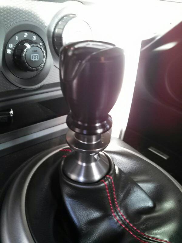

Just finished swapping the OEM shift knob and R lockout to the Raceseng one's. They do look nice (I mean really nice for both look and touch) but it just doesn't worth the work and the time needed to change them. After I finished I actually think that the R lockout might be better with another color, but I just don't want to undo and redo everything again. So that's it. Moral of the story: Unless you really love DIY or you are an expert (at least experienced ), pay someone to help you out, or stick with the OEM.
