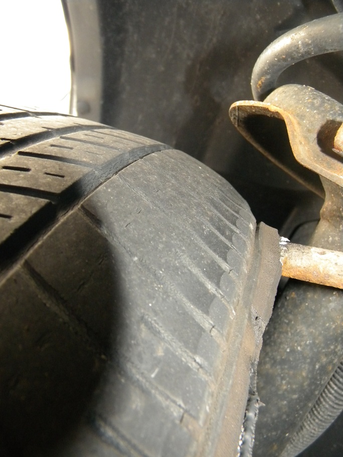

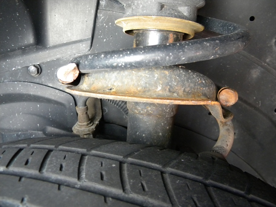

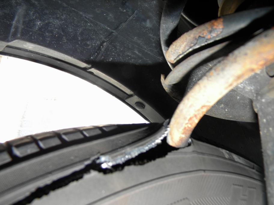

My daily driver (01 Saturn SC1) has been sitting in the driveway for the last 2-3 of weeks and today I thought I'd take it out just to run it for a while. The right front tire was low so I broke out the air pump and aired it up. Put the pump away and got in the car and put it in reverse. Tires were stuck to the asphalt by some ice and the car hesitated to move. Gave it a little more gas and it seemed to break free. Just then the left front of the car drops. I'm like 'what da fuq?' and I'm figuring that the tire was so stuck to the asphalt that the tire was pulled away from the rim and when I got out, it was flat. Go and get the air pump and hook it up, turn it on and nothing happens. So I figure the tire is off the rim and go get my jack. When I jack it up, I look in the fenderwell and see this:
Attachment 65442
Attachment 65443
Attachment 65444
Attachment 65445
That is the spring off the strut and it snapped, appears to have spun around with some serious force and impaled the tire. I'm glad as hell it happened in the drive and not on the road. Holy Crap! Car just broke 300,000 miles. :cry:
rice_classic 01-29-2014 09:48 PM
Rust, culprit looks like rust.

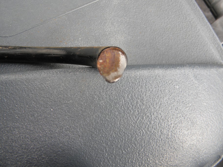

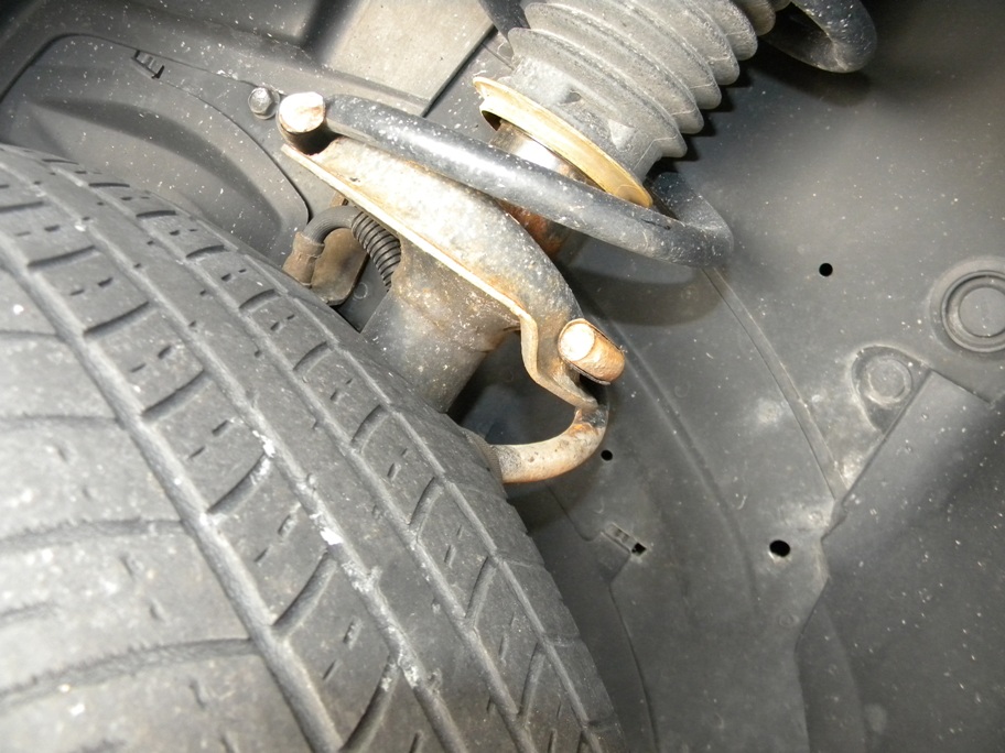

White64Goat 01-31-2014 11:22 AM
2 Attachment(s)
Originally Posted by FiRStsc10n (Post 1492802)
And that folks is why you don't drive a Saturn.
Why not? 300,000 miles......can't beat that with a stick. I'll drive it till it drops. Just installed 2 new struts and waiting for my tires to get shipped here. Spring was for sure cracked and finally failed.
Attachment 65627
Attachment 65628
