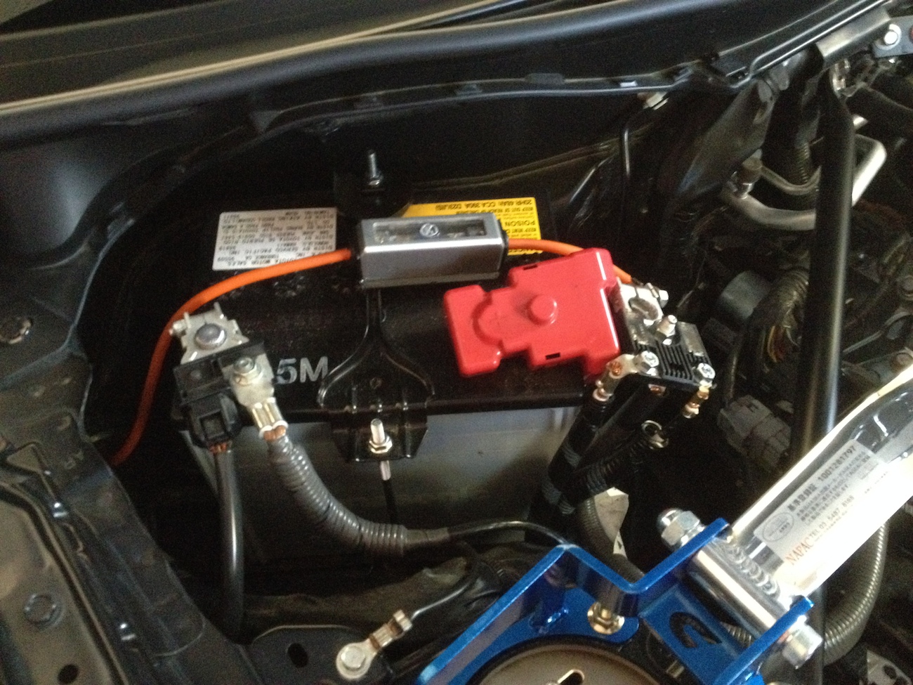

Step 1:
First you need to DISCONNECT THE BATTERY!!!

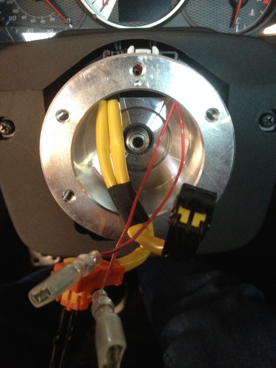

Step 5:
Attach the wiring harness with the red wires to the spot where the cruise control/horn harness was. (this is for your horn) Once that is in, put the hub on. Again Make sure it is straight and that the clockspring was not rotated. Feed the horn and airbag wiring inside the hub.

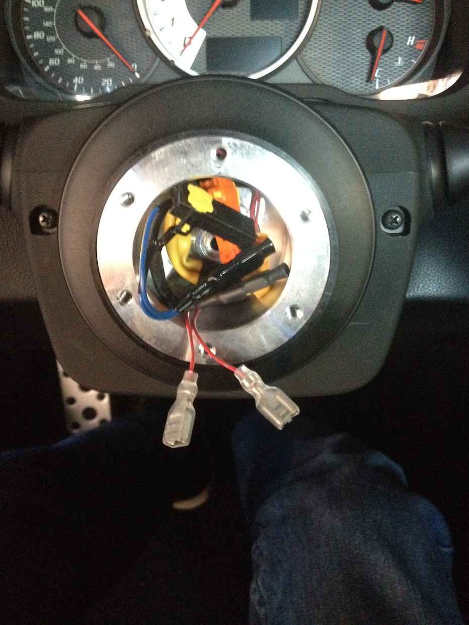

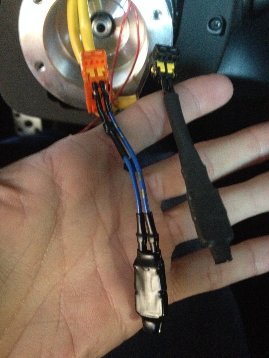

Step 6:
Put the 2 OHM resistors that came with the kit on the airbag plug ins as seen in the picture below. you might want to use some electrical tape so the resistors do not come out while driving or while installing the wheel.
Attachment 65264

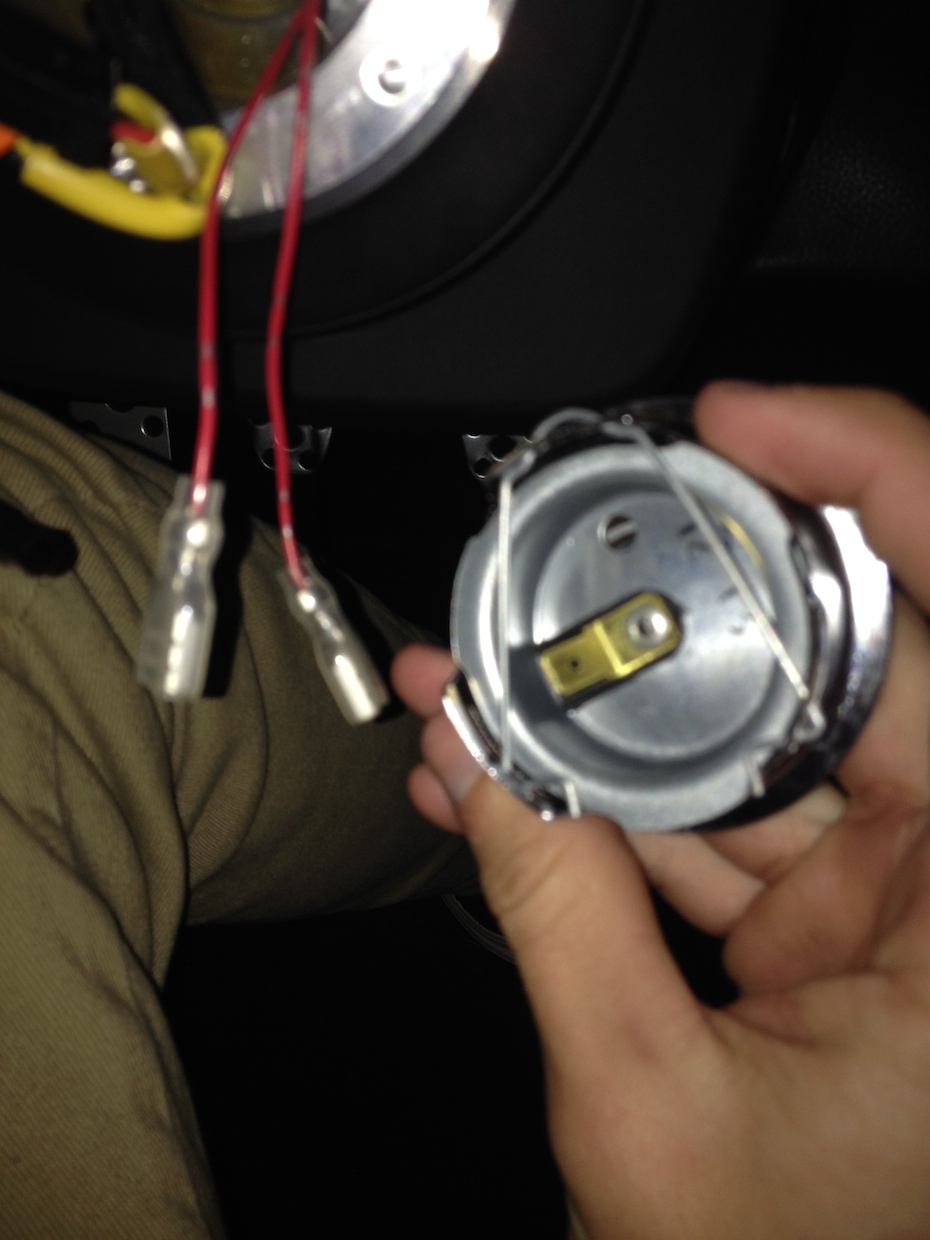

Step 8:
After to attach the wheel connect the horn with the two red wires. My horn button only has one male connector because it is a nardi button. Also if you buy a Nardi wheel with horn. the horn grounds itself so there is no need to make a ground. Just attach one of the female connectors to the horn.

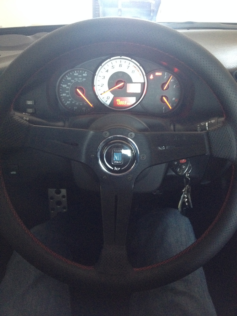

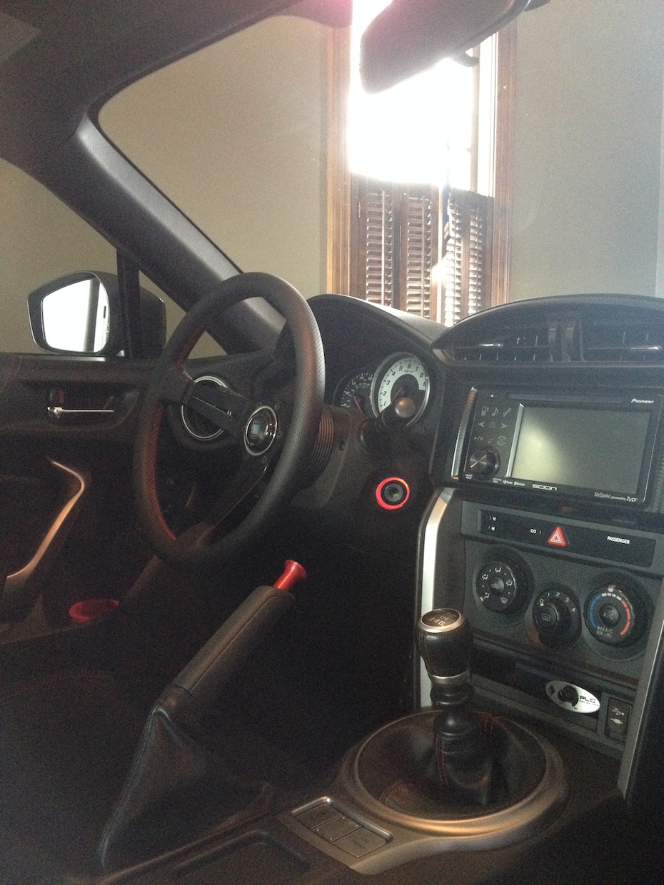

Step 9:
Attach the horn and go enjoy your new steering wheel. Also i had no lights after this install. :)
Attachment 65261
