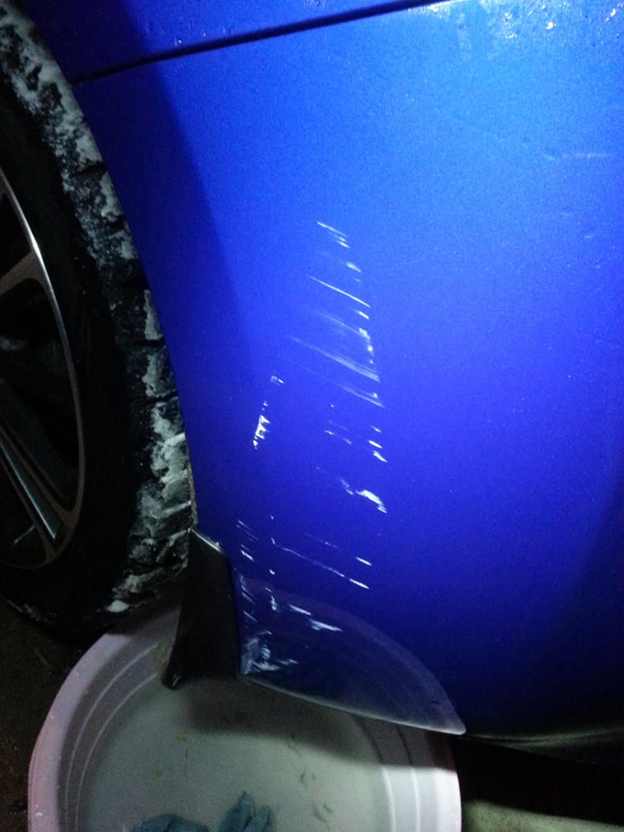

I accidentally backed into a cement column at a parking lot. I tried my best to fix it but if you look close you can still see the scratches. Anyone have suggestions to make it even less visible?
Before:
Attachment 65146
After: This is the best i can do. You can still see the scratches. Some are deep. Process was Scratch X 2.0 -> Touch up paint -> Ultimate Compound -> Ultimate Wax
Attachment 65147
Atticus808 01-29-2014 11:10 AM
wet sand
SloS14 01-29-2014 12:24 PM
build up, then wet sand
chenshuo 01-29-2014 06:01 PM
I've never done wet sanding. After wet sand how do i bring back the color and gloss?
Rayme 01-29-2014 07:04 PM
Then don't do it until you practice on something else, wet sand can do miracles if you know how to do it. I'd drive it like that and get a quote on painting it eventually.
Atticus808 01-29-2014 09:44 PM
when you wet sand you're inducing a bunch of scratches with very fine sandpaper. it'll look really dull and your scratches should be removed at this point. then you use a microfiber cutting pad with a compound and go over the area plus a bit more to blend it in. once removed use a polishing/finishing pad and a polish to bring it back to new
SloS14 01-30-2014 07:49 AM
I would suggest using a soft sanding block on the built-up (and COMPLETELY cured) touched-up parts.
People have fingers, and fingers+sandpaper can cause grooves.
chenshuo 01-30-2014 05:48 PM
do you guys think i can use Meguair's Ultimate Compound and use it with a machine to buff it out? without sanding?
Atticus808 01-30-2014 11:58 PM
try it
always find the least amount of aggression first
troek 02-03-2014 05:36 AM
good advice ^^^^
just be careful, if the scratches are deep enough you will burn through the clear coat trying to remove them. id say, if you can get them barely noticeable, leave it alone unless your 100% you can make it perfect without ruining it.
Carlitoz3 02-03-2014 06:44 AM
U can barely see the scratches.
Good job!
GT86drifter 02-03-2014 08:14 AM
its too late already since you sanded the clearcoat by now
if your feeling adventurous spray the area with clear and wet sand (water + 1500 grit)
