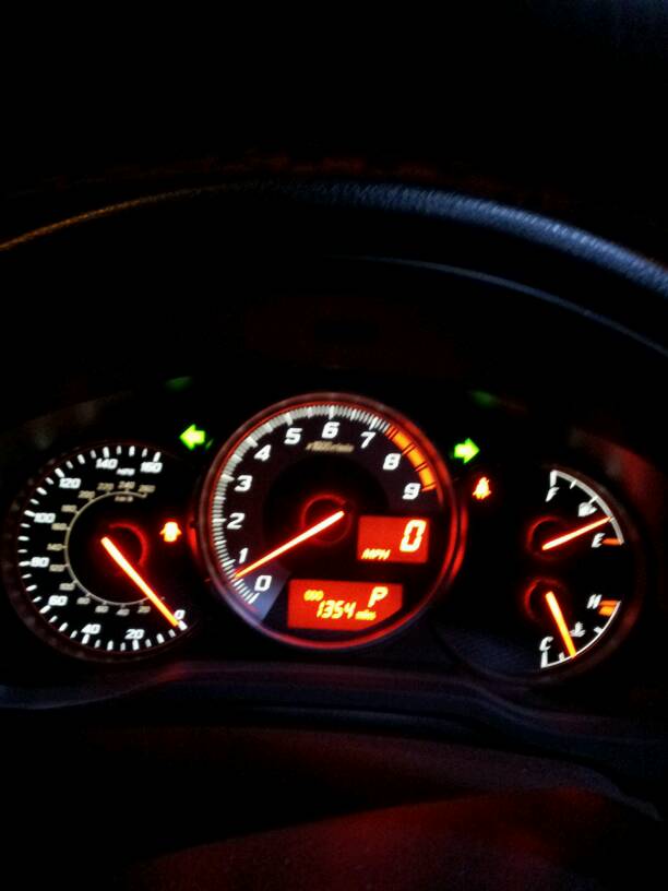

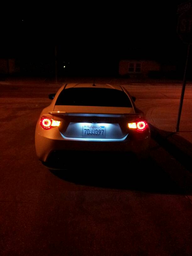

Dash blinker stay on after installing leds
2 Attachment(s)
How do i get them to turn off... I have the relay for leds installed too
And the tail light blinkers stay solid as well but blink when i use the signals
Attachment 65020
Attachment 65021
Sent from my SGH-T989 using Tapatalk 2
FirestormFRS 01-26-2014 11:26 PM
Bad flasher maybe? As easy as those things are to install it'd be hard to mess up.
SpeedyJay 01-27-2014 02:12 PM
What LED's did you replace?
I would also be guessing faulty flasher module.
Fr-Sheila 01-30-2014 04:39 AM
Got it fixed, apparently having both front and back turn signals led amber messes with the car
