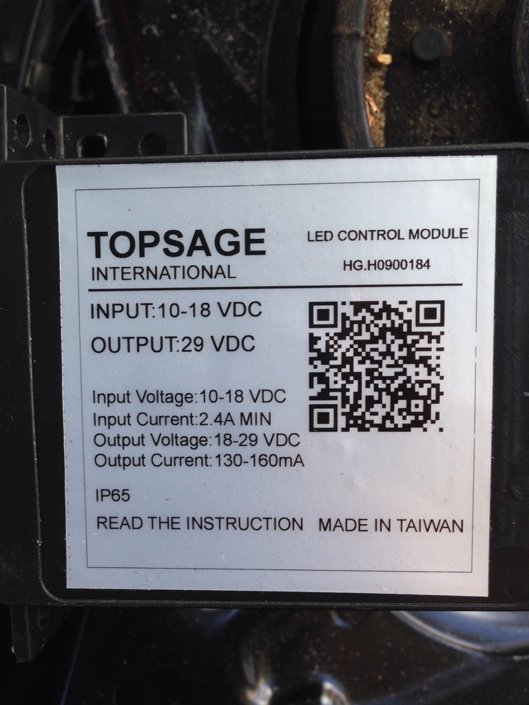

hayleybeaners 01-24-2014 01:10 PM
Led DRL Module
Does anyone have any idea where I can purchase a replacement module for this kit? I have tried multiple times to contact the vendor on this forum who I purchased them from, little under a year ago however he won't respond. Any help would be greatly appreciated.
Bryan

soundman98 02-17-2014 10:57 PM
can you get me a better pic of the labeling on it? if it lists the specifications of the unit, i might be able to recommend an alternative replacement.

hayleybeaners 02-20-2014 01:43 PM
Attachment 67744
soundman98 02-20-2014 08:56 PM
and here's your partial solution:
http://www.ledsupply.com/led-drivers...r-with-dimming
but it's partial because you will need to wire the above driver for boost mode(the manual is the .pdf file called 'datasheet' at the bottom of the page), and then use the dim/ctrl wires and a dmm set the current level it's outputting down to 130mA, because the full 350mA could cause damage to the led's the housing uses.
