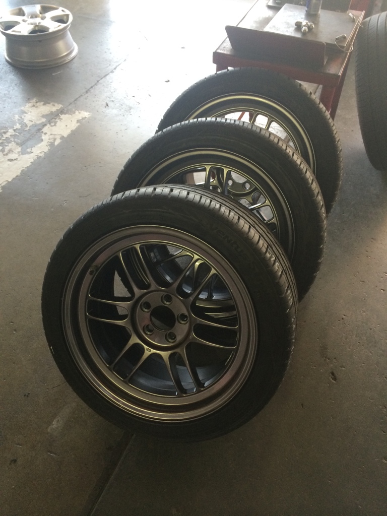

Gillams 04-01-2014 11:40 AM
The rite tire size? rpf1 17x9 +45
2 Attachment(s)
Attachment 72752Attachment 72753
245/40 on 17x9 +45, 5mm spacer up front.
