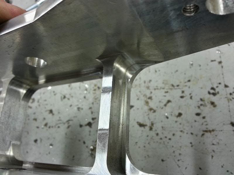

These through holes were drilled before having the meat of the arms hogged out. This leaves a small flap of material behind after the endmills pass over the holes (it pushes the metal instead of cutting the last section). Fix for this? Run the drill back in these holes after machining by hand, and that will cut away the flap, or use a deburring tool and sweep the holes.
http://img.photobucket.com/albums/v3...ps31637e3c.jpg
http://img.photobucket.com/albums/v3...ps3abb1cc9.jpg

Use your zero flute or deburring tool to chamfer these holes. This is another process that should have been done during machining using their center drill. Simply drive it slightly deeper than what's needed to center the drill that will be going through, and the chamfer is there.

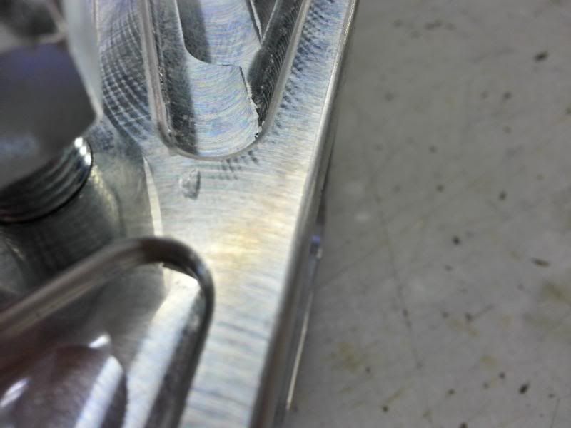

This DID come from machining. This is caused by the fixture/vice not being cleaned off from chips before this part was clamped down, which forces the chip in to the surface of the aluminum. Generally speaking, the guys that do the setup of machines don't do this, it's the button monkeys that we leave to run it our stead (bit of a rant, ha):mad0259:
http://img.photobucket.com/albums/v3...ps98267860.jpg
http://img.photobucket.com/albums/v3...psa065ec5d.jpg
http://img.photobucket.com/albums/v3...ps35d76f16.jpg
