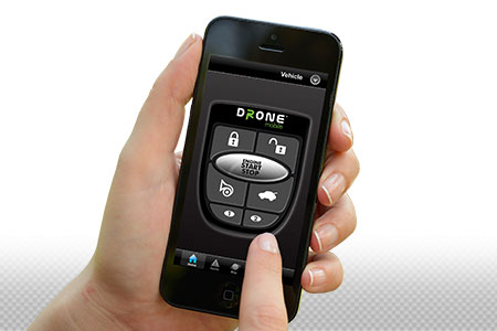

DroneMobile is similar to the SmartStart feature with Directed Electronics products (Viper, Python, Clifford, Avital, etc.). It's an additional module that can be installed with an Compustar alarm system that gives you the option of using your smartphone to lock/unlock/pop trunk/arm/disarm, view notifications and it is essentially functions as a 2-way remote.
Attachment 62789
If the alarm goes off you'll be notified on the phone and if installed correctly it'll notify you if which zone of the vehicles has been infringed upon. The downside to this is you must always have your phone otherwise you have no way of disabling the alarm.
