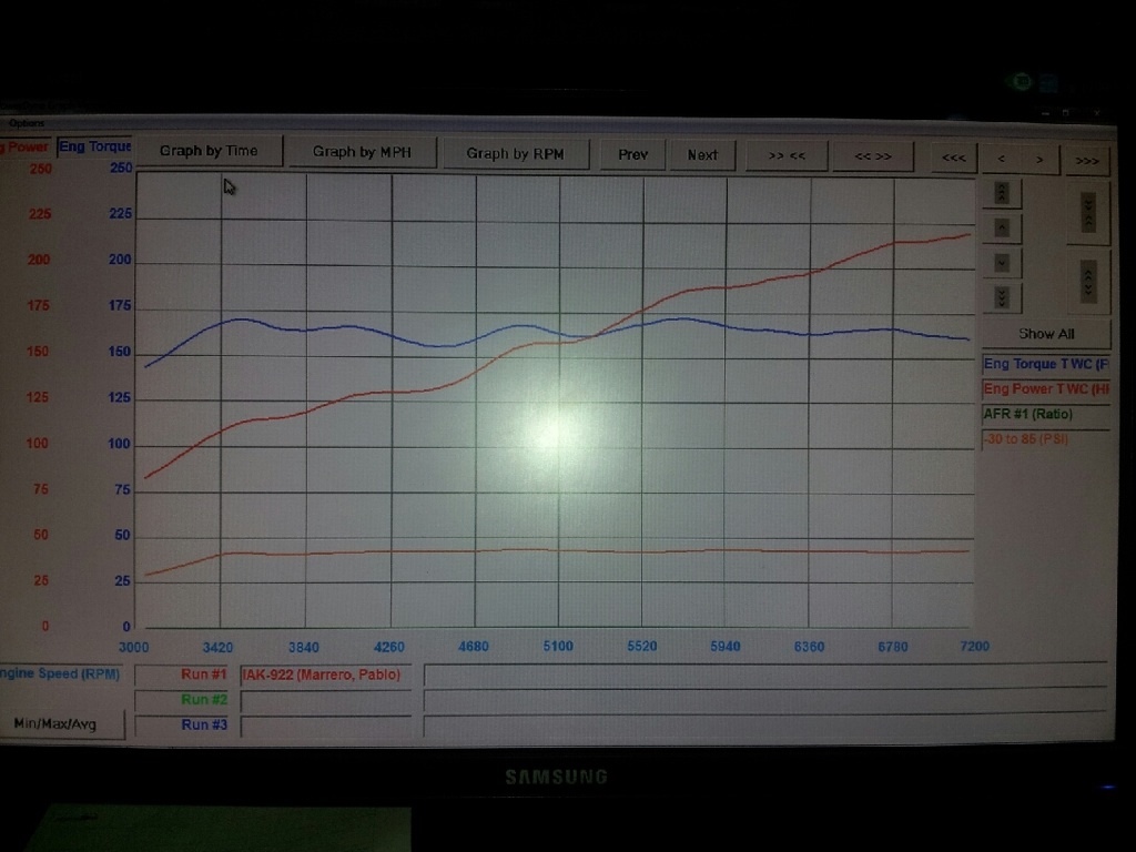

Hmn... Supposedly the way it fit it made the Perrin OP rub on the car's frame... Btw, how much HP are you getting from these kits? I have 2.5 inch exhasut from the op down and on a mistang dyno (7psi 91 oct) what i got was 225.... A bit heart broken. I know its a heartbreaker dyno but 225 is ugly. Heres the graph they got (tuned by them)Attachment 61679
maxjedi 01-01-2014 02:18 AM
Nothing ugly here, 225 is exactly what i would expect from greddy turbo on 7 psi 91 oct and maybe 8-10 hp more on 93. Torque curve is very nice. Greddy kit is for driveability, not fancy dyno numbers.
midnight23 01-01-2014 02:31 AM
^ what he said, I got my car back today and made 271 around 11 PSI on pump, same exhaust size mods but added fuel pump and injectors. stock frs dynos around 155.
