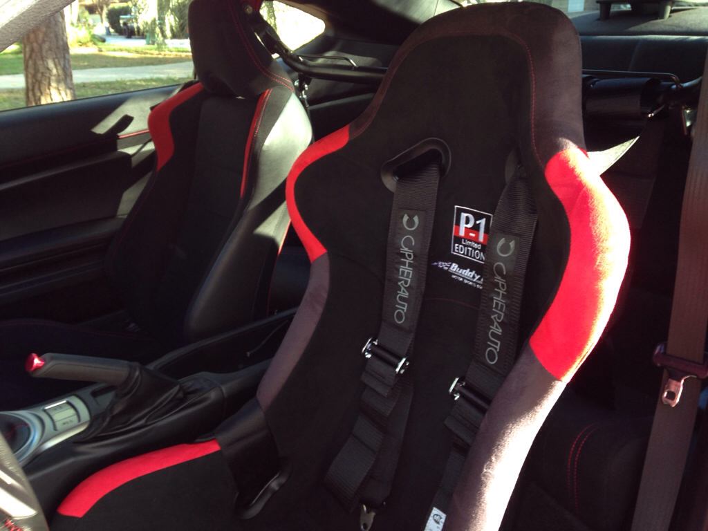

OICU812 02-01-2014 12:17 AM
Originally Posted by Ryaquinn (Post 1390315)
Attachment 60068
Buddy Club P1 with buddy club side rails
In comparison to stock how is seating height? I realize stock is adjustable but trying to get an idea. What height are you and what's your impressions this far on this seat comfort wise etc....
