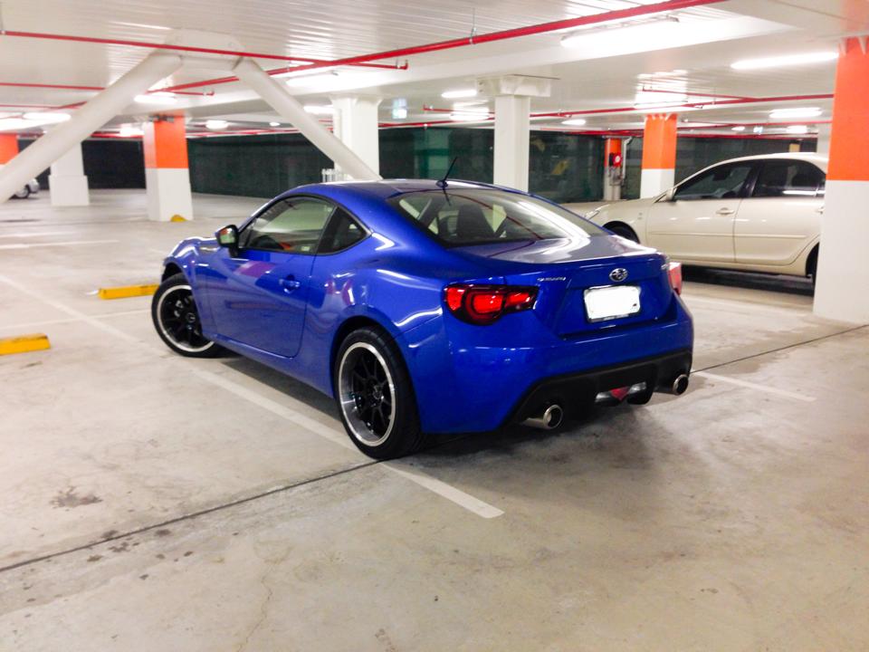

Since I've used posts in here as reference, should only be fair that I post these photos up - I haven't seen any/many photos of Tenjins... forgive me for the fronts not being straight, but they're perfectly flush. The rears stick out a wee bit though. Suspension is stock. (yes, I know the parking is a shit effort. :) )
Wheels: Enkei Tenjin 18x8.5"/9.5" with +45 offset all round.
Tyres: Yokohama Advan AD08R's, 235/40R on the front, 265/35R on the rear.
Attachment 58359
Attachment 58360
FunCon5 11-27-2013 02:29 AM
Very nice! Enkeis & Advans a match made in heaven! Perfect sized tires! Looks amazing!:thumbup:
Abdulla827 12-01-2013 09:11 AM
Excellent choice of rims, looking forward to some more pix!

These are so nice. I'm sitting on eibach sport line springs lowers about 1.3". Any idea how these would look? Wheels are not my thing :/
