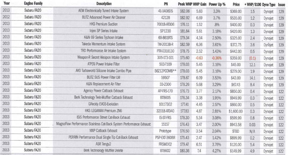

So I know some of this information is already up, and around on the the forum, but I figured I'd throw this list up for anyone who wanted a quick reference to it. All of the tests are from DSPORT Issues #122 and 129. I am looking for these issues so I can scan the related articles.
http://i91.photobucket.com/albums/k2...ultsDSPORT.png

Nice compilation! There is only resonated Perrin in the table though-worth adding the non-resonated version as well which is actually the best performer among catbacks.

Actually this is only the peak whp dyno results at 7000 rpm, which misses 90% of the testing that was published. Looking at the +/- over stock through the whole rpm range paints a very different picture. I wouldn't use this as a method of evaluation unless you only drive at 7000 rpm.

I have copies of the actual dynographs. However I need to call DSPORT to make sure I can post copies of them.

:( no perrin intake dyno. At least i know my investment in the apexi filter was a good one. i really want to justify spending $300 for the wheesh sound. Also, it would be nice to see more catback results. Thank you for posting this.
